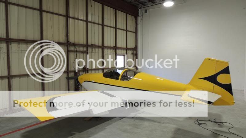

It's been a few weeks since I finished my Vinyl Wrap, so I thought it was time to post a quick video of the process.
The results look great. The cost was much less then paint, and the process was completed much faster.

What's the before and after weight?
I've been told by a Wrap company that the wrap weighs LESS than paint.
Arlen,
Its half the weight.
Great wrap. We prefer to use large one piece panels to avoid seams unless impossible. The seams are a huge focus regarding our installs.

Thanks for the nice comments. To answer a couple of questions, the cost was less then paint. I had a couple of quotes, and they ranged from 60% to 85% of what I had been quoted for the same scheme to be done in paint. As for weight, yes I am expecting it to be less then an equivalent paint job, as it is only a single layer. I just today got a lead on a new set of scales, so I will report back after I get the 'after' weight measured.
For me one of the nice things is how fast it can be done. It was only a few working sessions to complete the plane. I spent a week getting it really clean, and the wrap company came out for several early evening and one weekend session to get it done.
I guess the big question will only be answered with time. How will it look a couple of years down the road? Right now it looks every bit as good as paint. Only time will tell if I am still this happy in a few years. But hey, if not, the vinyl can be pulled and I would have a clean aluminum plane ready for paint, or new vinyl.
