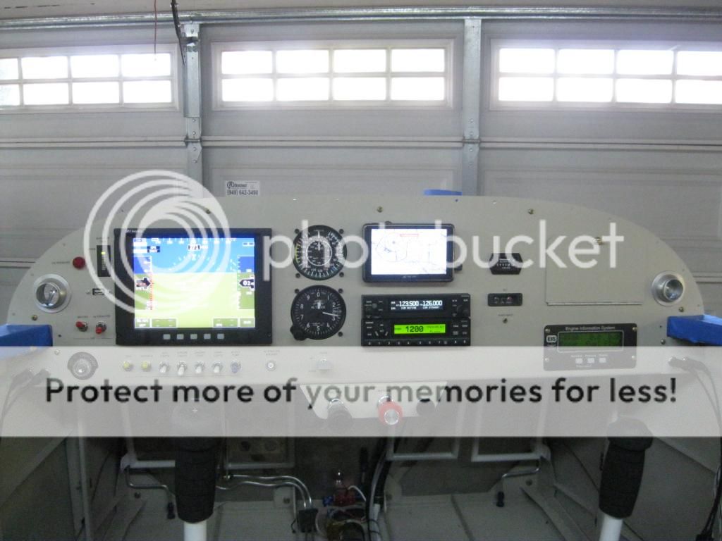

Dereck.....starting from left to right would you describe what your avionics are?
Hard to see enough detail to know for sure make/model.
Jim
Rv9a
Hard to see enough detail to know for sure make/model. Jim Rv9a
Jimbo, As follows: Trio Pro Pilot GX Pro, Garmin G3X's (x2), Garmin Aera 500, PS Engineering PAR100EX (audio panel with integral comm radio set up as comm2 & bluetooth music & phone), Garmin SL30, Garmin GMC 305 (optional autopilot controller). The transponder is a Garmin GTX 23ES remote mounted under the panel and the ADS-B is a Garmin GDL 39R remote mounted behind the panel as well. The ELT is an ACK E-04 remote mounted behind the baggage bulkhead. I have four DeltaPop antennas on the belly of the fuse for Comm1, Comm2, Transponder & ADS-B and one bob archer Nav antenna in the right wingtip. IPad 2 is mounted via a "Ram mount" ball swivel fastened to the panel.
I dont think I'll get lost The panel & firewall forward wiring has been the most educative and enjoyable part of the build for me. Now i just need to finish this baby before all of this looks like an ADF receiver

Originally Posted by YellowJacket RV9 View Post
I really like that color, what is it? And is that paint or powedercoat?
Chris
It is a gray PPG paint with a clear coat over the lettering (I believe) all compliments of SteinAir. Don't know the exact color code but they've done a few this color.

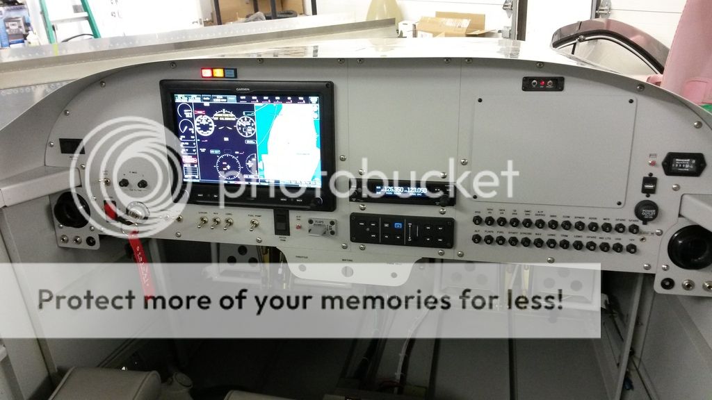

I finished the plane in October but held off on installing the GTN650 until last week. Now that the panel is finished I thought I could post a picture or two.
All Garmin. A joy to fly behind.
Under glareshield LED ligths turned on.
Difficult to get a good shot with a dark hanger and dark panel.
Mark
