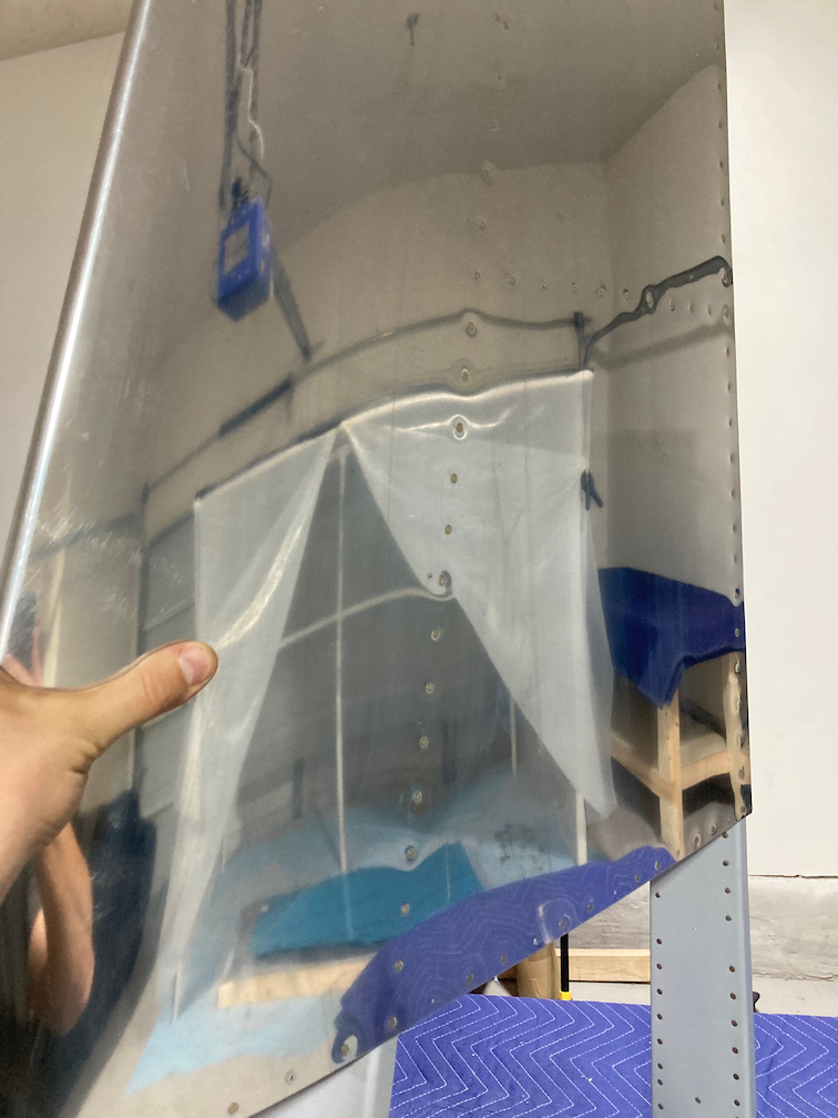

...and vertical stabilizer is finally complete, too (after rebuilding the whole front spar assembly).
Some random rivets inside the vertical stabilizer (I think, they look worse than the horizontal stabilizer ones, but hey, it took me much less time!)
Does not look like my dimples are crisp enough! However, I think, truly crisp dimples are a myth

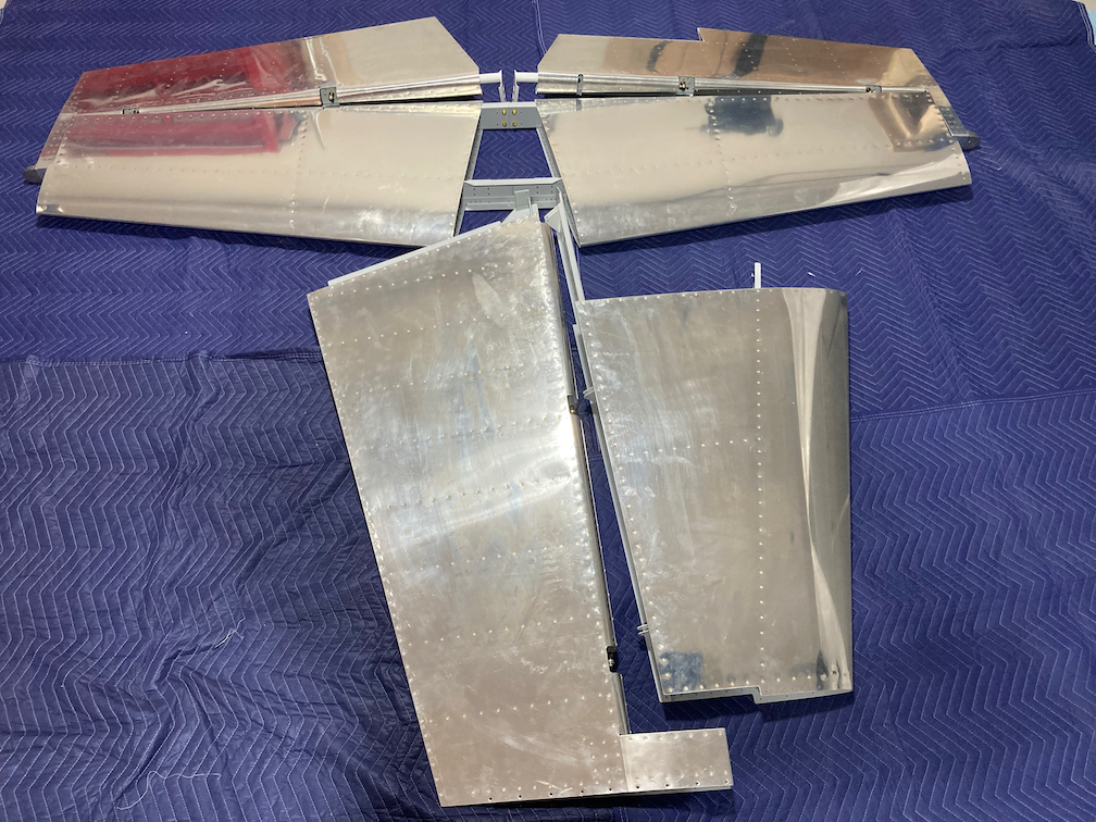

Okay, so the empennage parts are somewhat complete (except for the fiberglass and fitting parts together).
Still debating if I want all fairings to be removable or just the rudder bottom one (and maybe the elevator ones, so I can keep additional counterbalance weights inside them).

Old 08-03-2022, 04:58 PM
Taltruda Taltruda is offline
Join Date: Oct 2017
Location: Las Vegas, NV
Posts: 1,326
You can get crisper dimples.. they aren’t a myth. Cleaveland tool has a great YouTube video you can check out showing the difference between under dimpled and right ones. You either need to squeeze or hit harder, but also check the brand dies and if they aren’t quality ones such as brown, Avery or Cleaveland, you might find a difference there too.
https://youtu.be/DxQwh-X8gOc
https://youtu.be/Qo9QCMaNSoA
Tom
Las Vegas
RV-4 flying…
RV-8 empenage finished 10-2020
Wings Started.. 11-2020

I know, I was being a bit sarcastic, given all the discussions about "crisp dimples" I've seen. I primarily use DRDT-2 which I think I set up properly (lots of pressure).
I'll try more pressure (or maybe buy Cleveland dimple dies).

The pull rivets can be removed if you really want to remove a tip. That also means they can't be covered or the seam bonded or sealed.
The other method is to add a nutplate to the forward tooling hole on the elevators.
The rudder has a counterbalance but the part is not balanced before finishing.
