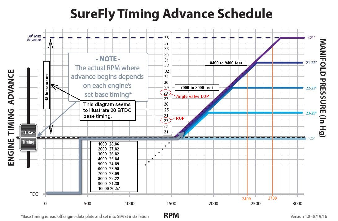

Let's look at variable advance. Here is the Surefly advance schedule. I've added some notes, specifically a pressure schedule for standard atmosphere, a scale for advance, and two RPM lines. The manifold pressure values Surefly has posted on the right margin are kinda fuzzy (23 to 25 inches, for example), so it's hard to know exactly what timing value results from a particular MP and RPM. A block schedule would be more accurate, but we'll go with what we have.
Bumping around at less than 5000 feet will keep timing at 25 BTDC or less. CHT's will rise some with rising advance. CHT considerations must get greater emphasis in the Husky application, as lower airspeed means lower available dynamic pressure. That said, I don't see a significant problem here, ROP or LOP.
With increased altitude, the schedule moves progressively toward one suitable for a parallel valve engine run high, fast, and lean. Assume 2400 RPM for cruise, and by 8000 feet the system has advanced past the 28~29 range we're finding optimum for an angle valve run LOP. Max advance for 2400 appears to be 31.5, not unreasonable for LOP but way past optimum for ROP. It's not a horror story, in that it should not break the engine. However, it is pointless given that it will come with a performance decrease, and a higher cooling load.
Let's return to STOL fun, 2700 RPM at best power mixture. Given a strip at higher altitudes, 2700 RPM has the system advanced to as much as 36.5 degrees, well beyond desirable timing for best power mixture. CHT will be high, a combination of lower air density (less cooling mass), lower airspeed (less dynamic pressure to drive the cooling mass), and peak cylinder pressure moved closer to TDC. I think it would be a very poor choice for a Husky, but again, it's the setting, not the product itself. The product gives you a choice.

I was just doing the same, but with pen to paper print of the timing advance schedule - yours is much more sophisticated. I think this really helps us get to where many are looking for this discussion to go - how does using this EI impact the operation, efficiency and longevity of my engine?
It seems that the advance curve and upper limit may not be optimal for operating an angle valve O-360. The fixed timing may be a better option for the Surefly in this application.

If, for instance, I'm not comfortable with the high end advance at 38*....
As others have noted, the system reaches 38 only at 2800 RPM. The 2700 RPM max appears to be 36.5 degrees.
...what impact would setting base timing for the EI to 23* rather than 25* have? If the EI thinks its at 25* when its at 23*, would that effectively limit advance to 36* max? What would you be giving up on the low end (high MP/RPM) operation?
The DIP switches allow the user to pick base timing of 18, 20, 22, 24, 25, 26, 28, or 30, fixed or variable. If I understand correctly, these settings have no effect on the advance schedule or maximum advance. In reality, they define the minimum running advance.

For the sake of discussion, assuming 25* timing (minimum running advance) set for advance on the Surefly, if you set it up with the crank 2* past TDC (instead of 0*) would that give you an actual timing/minimum running advance of 23* and max advance of 34.5* at 2700 rpm?
Assuming there's no reason you wouldn't want your timing set to 23* (and there may be a myriad of them), would this be a reasonable way to limit the advance and some of the negative consequences of high advance referenced by others earlier in the thread?

Perhaps I'm not understanding here but I hope Surefly isn't saying that best power is made at 38 BTDC?
This flies in the face of plenty of dyno and flight data saying that isn't so. 38 will give you way less power, high CHTs and detonation almost for sure.
They are still mulling over the data before they give me an answer, but their immediate thought was it should only give you more power, so in essence, yes. I asked if they had any test data for high DA and that info wasn't available.
Just to be clear my setup is one Slick and one Surefly. I think for me its fairly clear to me that their advance is probably terrible for us people trying to get off the ground in Colorado. The plane sure starts nicely though!

If I may add to Mike's illustration...
If your EI choice is not switchable between best power and best economy ignition advance schedules, install a best power schedule.
Yes, that advice flies in the face of claims made repeatedly. Humor me a moment.
Many EI users conflate two separate EI factors. One is the ability to light less-than-optimum mixtures, a function of spark duration, energy, and wide gap. The other is the incorporation of variable advance. A user will install an EI, and then gush about his new lower fuel burn, easier starting, etc, while silently pondering his new higher CHTs. He often fails to understand that most of what he loves about his new EI is due to the spark, and much of what he dislikes is due to the timing of that spark.
Two weekends ago I found myself flying side by side with another RV-8. The nice young man was a relatively new owner, with a limited grasp of things in-cowl. Beautiful airplane...with very high CHTs. Before we went flying, I took a look under the cowl at his request. Yep, it had all the usual baffle seal errors, and lots of leaky spots, and a blast tube, and even two totally empty holes in the rear wall. I explained the needed corrections and stuck some aluminum tape on the worst spots, just so he could observe a difference when we went aloft for a visit to another airport.
The ignition? One Slick, and a P-Mag, with no jumper, which means an advance schedule beginning around 28 and maxing at 38 degrees BTDC. I suggested at least installing the jumper to subtract 5 degrees or so, and offered to do so, but the owner said no, not without consulting his own expert, who had apparently blessed the whole setup at least once before. Hey, no problem here...just don't forget.
So, we're cruising about 3500 and 150 knots TAS, the hot CHT airplane leading because he doesn't want to push CHTs. He was throttled, so MAP was low, so the P-Mag was advancing. The numbers? 11 GPH and 360-380F for a 360 parallel valve, vs 7.5 and ~315F for my 390 with an EI at a fixed 23 degrees. He was flying at 3500 because climbing got things too hot too quickly, and slow and full rich to keep cruise CHT below 400.
Sorry, that's just dumb as dirt.
Yes, I can hear keyboards warming right now. Yes, I'm sure you enjoy wonderful efficiency with your highly advanced EI after slowly climbing to some rarified altitude. However, before going further, consider this question: Have you ever flown back to back tests with your EI fixed on a standard 25 BTDC (parallel valve), vs highly advanced?
Well, some of us have, and here's the bottom line. Optimized best power and best economy require two different advance schedules. If optimized operation is your cup of tea, your dual map EI choices are currently limited to SDS and EDIS/Megajolt.
If only one is available, install the less advanced best power timing, as any speed lost to insufficient advance at best economy can be recaptured simply by flying higher...and when there is no climb cooling problem, it is easy to get there quickly. It's also easier on the engine; lower peak cylinder pressures, lower temperatures.

Have done a lot of flight testing now on a PV 540 and see no gains in power ROP WOT at over 25 BTDC. 50-75 LOP up high WOT, MPG peaks with around 30 BTDC. Some other folks have reported best MPG at 30-33BTDC LOP. Maybe so, but I haven't seen needing more than 30.
You'd simply never want to run 38 under ANY circumstances on a PV Lycoming and especially so WOT, ROP and down low. CHTs will be through the roof, power will drop off noticeably and you seriously risk detonation damage.
I know for a fact that one EI manufacturer relies on Beta testers to supply them with optimal timing figures rather than doing their own flight testing. Not such a good plan in my view. Others want the curve kept secret. Again, why?
Surefly had the resources to get this right before any product was sold to customers but it seems from at least one post that they also don't have a clue about appropriate timing values. I hope that one post was in error.
Blunty, anyone advocating 38 BTDC ROP and at high MAP, is no expert and should bear responsibility for engine damage if that's what they are advocating with their EIs.
Proper ignition timing is important stuff for your engine to perform well and last a long time. Use science here, not guesses. The information has been out there for some time now.
After all these years of debate on ignitions, the light bulb has gone on. operation at high DA/ROP, An electronic ignition optimized for LOP Operations may provide less HP than one optimized for ROP operations.

My experience is similar with the new 540. I have my base curve set to give me around 32* at 21" of MAP. My megasquirt setup has both a second advance table that I use to up the timing 2* at lower MAPs and also have a 4* retard from the base table. I can set each of the two ignitions interdependently (important as total timing is a composite of the two spark events). As I play with the settings at cruise, I am only seeing only about a 2 knot variance as I play with timing in the 30-35* range. Not enough time and testing yet to correlate all of the variables to determine a best advance, but my gut is that it is right around 32* when LOP at 8000'. That said, we all fly at different levels of LOP and that will give us some variability in optimum advance.
I have my advance (both tables) set at 23* above 27" and have been playing with the 4* retard beyond that to experiment with CHTs. At 55 hours, I still haven't seen 400* CHTs (max that I have observed is 375) and that includes break in. Though that was done in ambients below 40*. That said, I did use a more agressive advance to raise my CHTs during the break in, as I was struggling to get CHTs above 340 and felt it was impeding my break in.
I had never given a lot of thought to these crazy canned timing curves, but after this thread, I really feel for the users taking off from high DA airport's. I just can't imagine someone stuck with a 38* advance at full rich. In my 6, I had some heat issues in the climb as the MAP came down (timing was still well less than 38) and the answer there was to use a 5* retard in order to accomodate ROP climbs.
We all know that the fixed timing of the mags is a limitation, but we need to recognize that many of the modern EIs are also fixed to a large degree, as they don't include enough variables to be optimal across our engines operating envelop. Kudos to SDS for creating options to real world requirements. I would never consider and EI that didn't have at least two discrete, user selected advance tables.

I wonder if an electronics whiz will engineer a LOP/ROP switch that we see in other systems for the Surefly to control the timing schedule that is done when installing the SIM.
Let's assume that data point was an outlier, a case of one misinformed individual, or a communication error. And arguably, every P-Mag owner flying without a jumper got the same instructions.
In Surefly's defense, remember the standard EAB versions allow the installer to easily set one of eight fixed timing choices, or one of eight more variable schedules. No laptop or expensive accessory needed, just set the switches. Put another way, if it doesn't get installed with reasonable timing, it's not really Surefly's fault. The installer has easy options.
Just a side note, the new six cylinder pMag has a switch that locks the timing at 25 degrees (or whatever you set it at) or in the timing advance position (you set the max timing advance on install). The switch is operable at anytime - as in you can select in flight.
I?m told this was a requirement from the FAA for them to get this ignition approved for certified aircraft.

The DIP switches in my SureFly are set for 25* fixed timing, the same as the Slick mag it replaced. SureFly recommends fixed timing for any engine that may use auto gas and I wanted to have that option. My mission profile is primarily short low-altitude flights so the greater economy that advanced timing might yield at higher altitudes and longer flights is not a priority for me. I also don't know how the advance curve is configured and have no desire or reason to explore it.
The SureFly so far is an excellent alternative for the impulse mag it replaced and was a quick and low-stress plug-n-play. I suspect this device was intended primarily as a mag replacement. Other more 'experimental' ignitions may be a better choice for those who wish to explore the corners of the ignition envelope. But maybe SureFly will be forthcoming in the future with more details about the advance curves.
