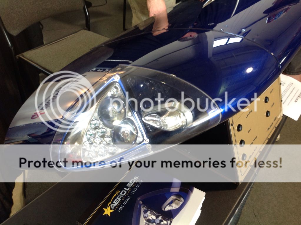

Here is a pic of the AeroLeds that were on display at OSH. That's a NAV light with stobe in front of tha landing lights. I really think this is going to replace all in wing landing lights one day. They are lighter and use less power.:)
The new AeroLEDs are probably my favorite of available options, but I'd really like to see someone demo what the light coverage in front of an actual aircraft is. On the one hand, they appear to sit further forward than the standard tip lights, but on the other hand, a lot more of the lighting comes from further into the lighting recess. Thus I figure they're probably a wash vs. the standard tip lights in terms of coverage, but I'd love to see a demo showing otherwise.
The Aveo ziptips really look like the coolest option, if they ever make it to production...but with the delays continuing without apparent end, I don't have a lot of hope that they'll have a real product out any time soon. Plus it sounds like they'll be expensive with a capital E.

  • AeroLEDs look cool, but I'm skeptical that they won't have the same old coverage issue as other tip lights.
