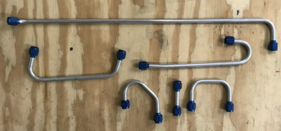

I have been helping a STEM program build a RV12iS and they received the tubing shown in Post #2. It was really nice to have that group of tubing done by the pros. I’m sure the mentors and students could have had a lot of practice and redoes by trying those challenging tubing fixtures.
Just saying they were really nicely done and thanks for the support from TSFlightlines.
