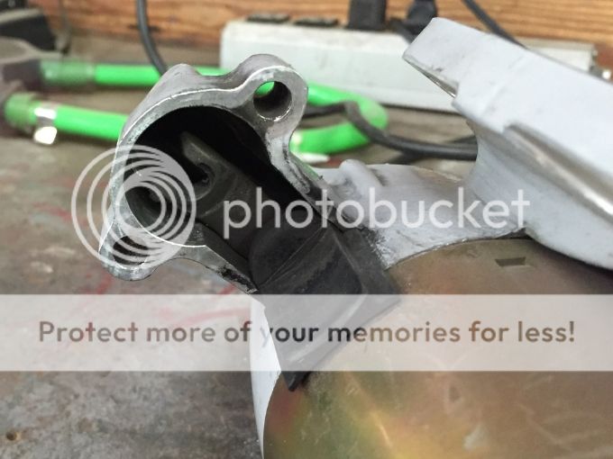

Default Can't get the solenoid off...
We are trying to take the solenoid off a skytec starter. We got the 2 bolts on the front off, and it moves back about 1/2", then stops. Seems like it is catching on the starter gear.
Any suggestions??
Joel
N626JA
RV-7A at CXP
Flying!
Old 06-15-2016, 02:25 PM
dlloyd3's Avatar
dlloyd3 dlloyd3 is offline
Join Date: Jun 2005
Location: Locust, NC
Posts: 446
The little white button shape on the end fits in a slot on the engaging lever. Pull the solenoid back as far as possible, move the button away from the motor and it will slip right out of the slot. Simple once you've done it.

Default Thanks
Sweet! Will let you know how it works.
Just as Dave said above. Here is a pic that may help the next guy.
