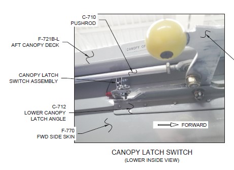

Van's Aircraft has released a pair of new optional kits that will enable RV-6/7/9 owners to install safety-enhancing options that can help ensure pilots do not take off with their tip-up canopy unlatched, which can be a distracting and/or dangerous event.
For people with an RV-6/7/9 tip-up aircraft (and the "A" variants, of course), Van's has developed and released a new OP drawing as well as two safety-enhancing kits that owners can install. These kits provide the parts needed to install a tip-up canopy latch warning system. This system is designed to provide an audio warning/EFIS annunciation whenever a tip-up canopy is not properly closed/latched, and the engine RPM is above a threshold such as would be the case during an engine run-up or in flight (greater than 1600 RPM).
For aircraft with an EFIS installed, you can order part "TIP UP CANOPY LATCH WARNING" from Van's Aircraft. You can connect the warning system's switch wiring to an available analog input pin on your EFIS/EMS system, and configure your EFIS as per the "Canopy Warning Read-Me" instructions available from the Downloads page of the Van's Aircraft website. Refer to OP-61 for details.
If you have an aircraft without an EFIS installed, you'll need part "TIP UP CANOPY LATCH WARNING" as described above, plus part "AV-01957 INSTALL KIT," which provides the components needed to connect the latch/switch system to your intercom and generate audio alerts. Refer to OP-61, pages 04-06 for details.

Looks as if the canopy closed switch for the 6, 7, and 9 was an afterthought.
It stocks out in the way and hasd exposed wires. The switch should be more enclosed or behind the F768B-L. Doesn't look very professional.

Just for context, the un-cropped version of the photo used in OP-61 shows the Advanced Control Module and the other "exposed wires" that are very commonly seen when avionics are mounted to the aft side of the F-768B sub-panel.
Look at it this way, how many builders (or maintainers) want to panel-dive behind the sub-panel when an item can be mounted in an easily accessible area behind the instrument panel? This microswitch requires adjustment during installation and that would be much more difficult to perform if you had to panel-dive.
NOTE: there should be an MS25171-3S Terminal Boot on the ACM positive terminal.

Cool that Vans has an official way to do this now. I wouldn't have thought to put the switch there! I chose to do two switches, one on each of the "fingers" that engage the canopy hardware when you close the latch:
The system from vans does have two switches. It is designed to assure that it can’t accidentally detect the canopy closed and latched, when it actually isn’t.
One switch detects the physical position of the canopy latch mechanism and the other detects the actual physical position of the canopy.
Wow, I'm dumb. Didn't notice the second switch in the latch itself. Nice design.

For a retro fit, it’s much easier and cheaper to add a contact switch to the canopy latch as Draker has done. Mine is configured to contact the latch lug so it cannot be tripped without the canopy being closed and latched, so only one switch is needed. Switches available at Amazon-10 for $6. https://www.amazon.com/dp/B07ZVJD1GC...roduct_details
I glued mine on with RTV and it seems quite secure. Quick and easy. My plan is to drill for a #4 bolt only if needed because failure would only result in an “OPEN” indication which could be quickly and easily identified as false.
