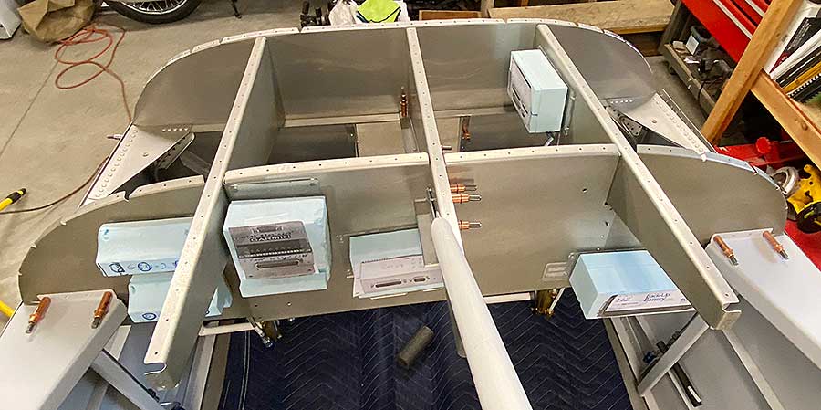

I spent an evening making mock up cardboard boxes. The next day I was suprised.
I fabricated two shelves. They are mounted with hinges fore and aft between the panel and sub panel. They can swing down either way or completely removed easily.

Here's a way to defer buying the LRUs until later.
Make mockups of all the LRU's out of foam and use double sided tape to figure out where to put them.
You can make up your wiring harness with these in place before you spend the bucks for the components.
