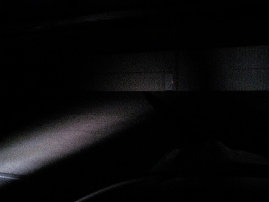

Default some comparison
marginal photos. 50W halogen on the left, 10W LED on the right. the left side is pointed downward for taxi.
10W LED on the both sides. On a four mile ILS final they said they could see me fine. good enough for me.
