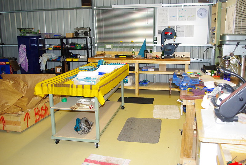

Just looking for some ideas and advice. I am in the process of setting up my shop. I am going to build in a 2 car garage and have spent way too much time and money making it a very livable man cave for which to build an RV14. I have run new electrical, new lighting, insulated, heated, painted, and everything except the benches, tables, etc. My first part of the kit (wings) arrive in a few weeks.
Does anyone have pics or drawings of their shop layout including the size and height of the benches, how many, any jigs, and anything else that you might think I will need. I have a very understanding (and lovely) wife that will almost let me get away with anything for this project.

If you put the benches and floor tools on wheels, the layout will find itself as you go along.
Second that. I'm building a wholly different airplane, an RV-3B, and find that the empennage needs a different shop layout than the wings, ditto the fuselage, etc.
Make things movable. It'll be easier because you'll move them around anyway.

I have the luxury of a large shop - some would say huge. I started with fixed benches. Now, most everything has wheels.
I reconfigure different areas based on the milestone of the project (or projects).
Even the fixed benches are on wheels. Why? Because at least twice a year something comes along and I need space for a week of two. In those cases, even the fixed equipment gets their casters unlocked and everything moves.

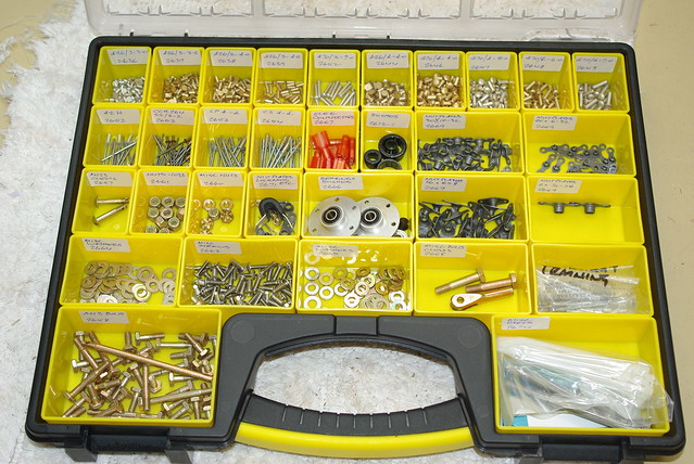

Need someplace to store parts and assemblies as you go. Long 24" wide shelves suspended from overhead are really useful. Mine are welded 3/4" angle frames suspended through the ceiling on all-thread rod. Ply panels (1/2") fill the frames.
One HD fixed bench bolted to the wall is good, with everything else movable as noted. The fixed bench gets the big bench vice.

Two car garage. Painted floor, fixed bench at rear, all other benches on lockable nylon casters, good lighting (3 wall fluros, 6 suspended from roof), band saw, vice, sander/scotchbrite wheel and drill press on fixed bench, 4 double power outlets around the walls, belt driven compressor out of sight in top right corner, beer fridge under sander bench. This layout has worked very well. Everything is within easy reach, and benches and project can be moved around as required.

I was able to scratch out a 2-1/2 car garage and am using all of the space. If you can, consider a 2-1/2 or 3 car garage. You can't have a large enough garage or enough tools - right?

Too long. 8' is plenty, shorter is probably OK. I have a 4 x 8 brute of a table that is accessible from all sides (in addition to std depth counters around the walls). If your shop is big enough for that plus some room for wing jigs, I would recommend the "freely movable" table.

1) Organize all parts so you can lay your hands on them in 30 seconds. Keep a list of parts and where they are by part number. This can be done in an Excel spreadsheet, sorted and printed out.
2) Organize your tools so you can lay your hands on them in 10 seconds.
