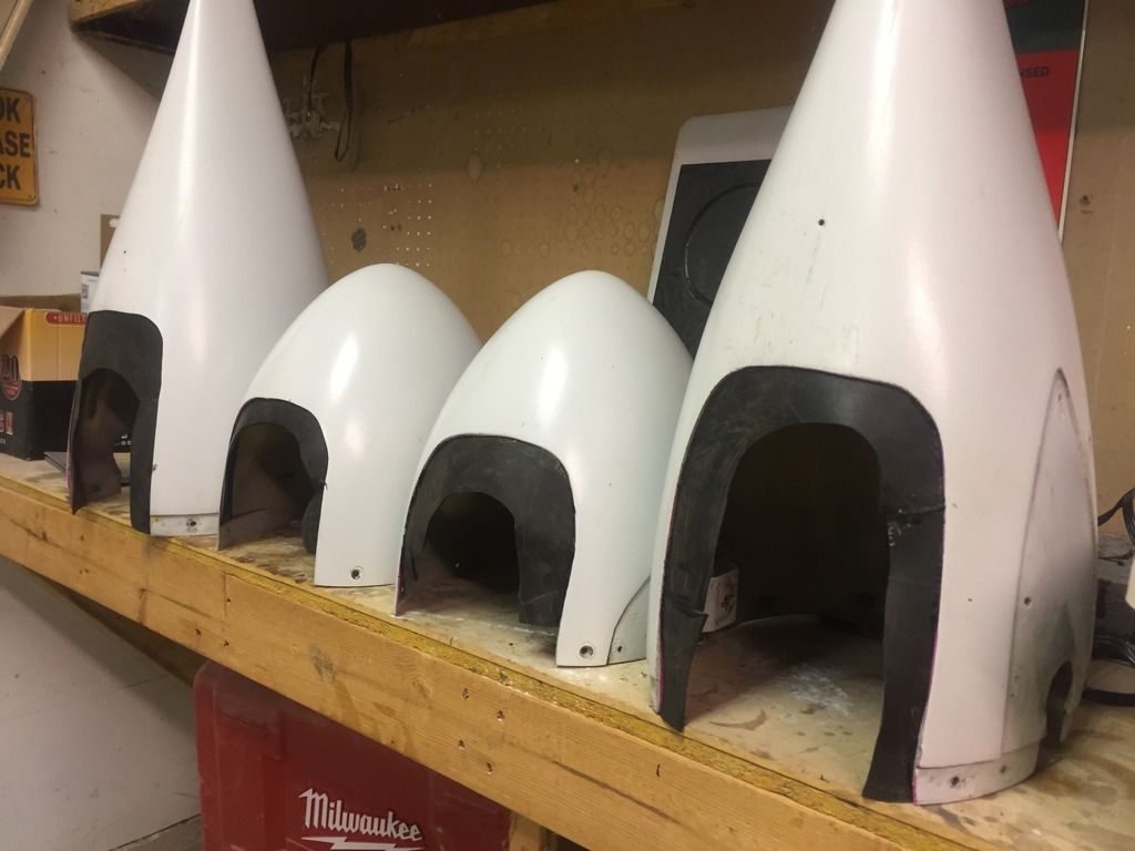

As far as I can tell my CHT's and oil temps have remained the same in climb/cruise as before, but 2ish knots faster. I still haven't cleaned up the outside portion of the exit, someday....
I installed new Desser Monster Re-Treads and since the wheelpants were off I attempted to reduce the gap/seal the wheel pant 2 tire gap. I mounted my wheelpants slightly higher with a fairly large gap (.5-.75 inch) to minimize damage on grass strips. This is a pretty cheap and easy experiment since I'm using my old tubes for the seal and leftover weatherstripping adhesive. I started with a cardboard template, which probably would've worked well with a flat rubber sheet.
I split the old tubes open and proceeded to cut and fit the rubber to the wheelpants.
Because of the shape of the rubber tubes I had to use multiple pieces to fill the gap.
Oversized rubber strips all glued and ready for fitting and trimming.

On a positive note the seals conforms better than I expected, on the downside I need to remove several of the strips that were too narrow and make wider strips for the inside. They don't seem to cause a lot of friction between the tire and seal when rocking the airplane back and forth, I'm sure it'll get pretty warm at 60 knots....

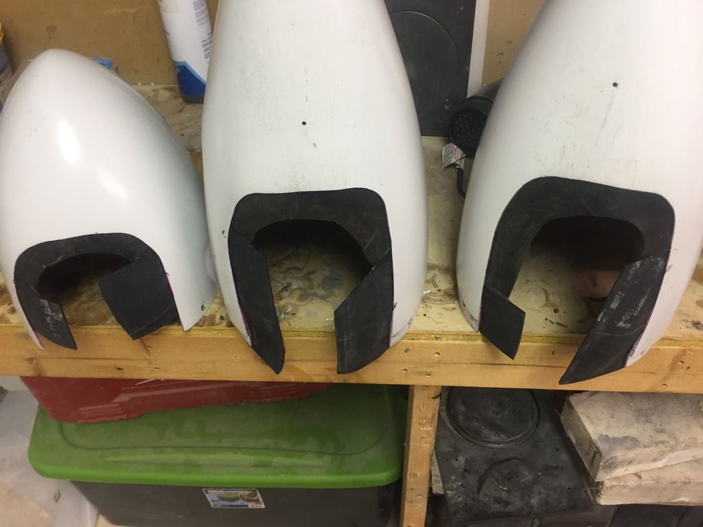

I found it easiest to cut the center thicker part of the tube out first.
Then position the tube in the wheel pant and mark the edges with a sharpie.
Larger side flaps added....

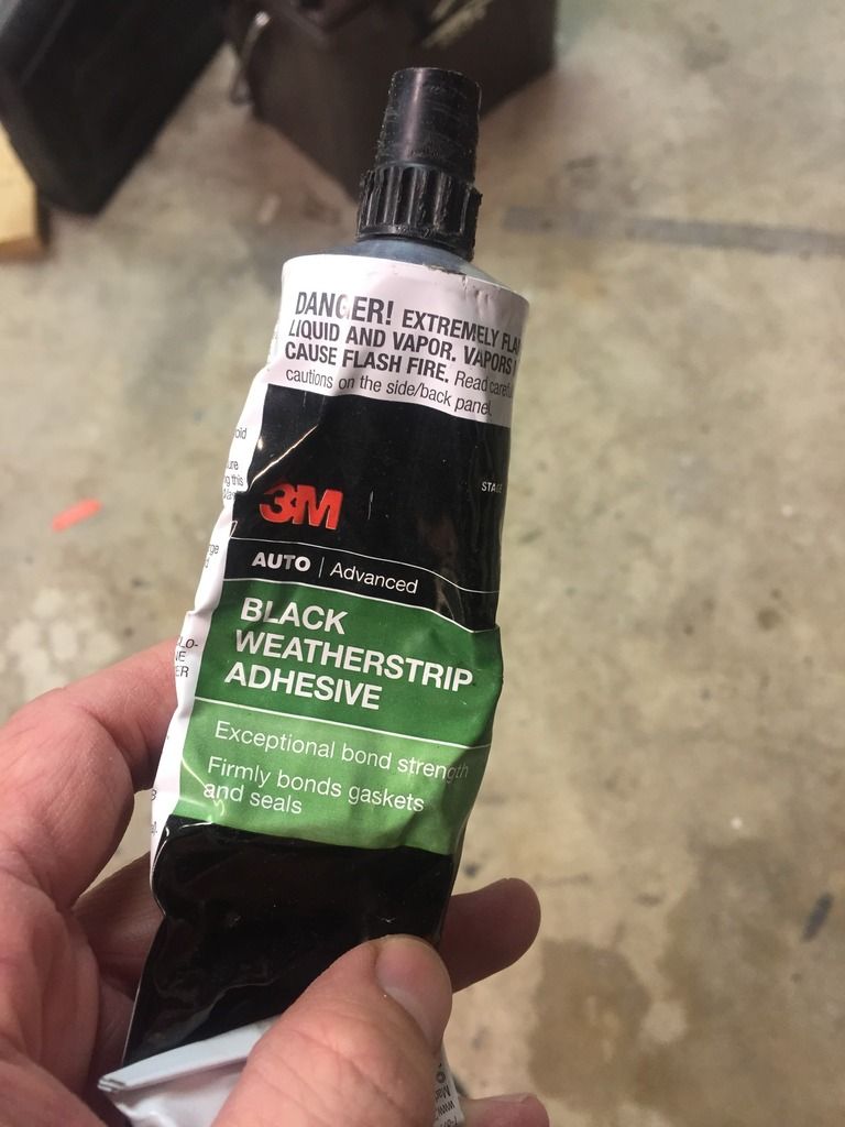

Can't wait to see the flying results! What glue did you use?
Mike, 3M weatherstrip adhesive from the auto parts store I had laying around.
