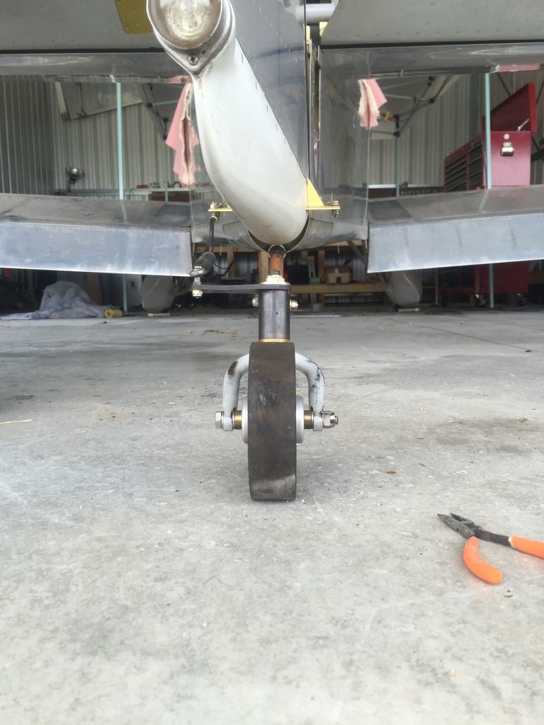

As part of my annual I also addressed the slop in my tailwheel and tailwheel spring. I added taper pins to my tailwheel yoke but found I still had a little bit of slop in the tail wheel spring to bulkhead mount as well. I used a B&S #2 taper pin reamer and a AN386-2-14 taper pin, the taper pin was way longer than needed but figured I could cut off the excess. I made this "jig" from scrap wood to hold the tail wheel fork perpendicular to the longitudinal axis of the airplane, I figured a large square of 3/4" plywood on a flat hangar floor with a 2x6 and spacers of plywood at 90* wood (pun intended) do the trick.
The jig worked well to hold the tail wheel yoke at the correct angle, but with the hole reamed to the correct depth for the taper pin left some hole slop to the left of the taper pin.
Reaming out the slop in the top of the hole ended up using the entire length of the An386-2-14 taper pin with lots of length protruding up. I tapered the inside diameter of some stock to make a large washer until I can order an AN-386-3 taper pin. It sure is messy and oily in the back!
The tail wheel is solid and straight now with no slop.

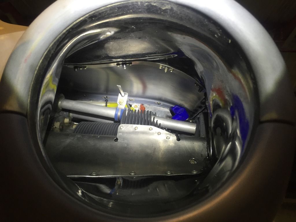

Another set of runups and de-cowlings made the first test flight a go! My goal was to incrementally increase speeds and record upper plenum pressures only, and not crash. I was astounded by my impossibly high upper plenum pressure readings but the airplane was performing normally with slightly cooler cylinder temps. I wasn't able to gather all the data I wanted due to lower clouds but still got in a .6 which was plenty for a first flight. After I realized I recorded pressures for the flight in mmHg they were much more believable converted to inches H2O. Looks like I picked up approximately 1.5 inches H2O across the speed ranges in the upper plenum and about 1 inch extra prop blast at 100 knts with the new cooling intakes.
I lost approximately 2 knots on the top only referencing my calibrated true airspeed. I was kinda expecting more speed loss actually, hopefully gain it back tweaking the exit next.
Oil temp seemed about 5-10 degrees hotter compared to the lower CHT's and topped out about 205 running full power, more investigation required.
Post flight inspection of the intake boots and cowling was good, I noticed 1 small crack on the front of the plenum/intake boot joint.
The intake boots are already showing some wrinkles....

Again, to be expected. Higher upper plenum pressure with the same exit size means higher mass flow. Cooling drag = mass x velocity loss, so higher mass flow means more drag. Squeeze down the exit area to return mass flow to the previous level. Upper plenum pressure will rise again in response to exit throttling. The drop across the engine will remain the same, so exit velocity will increase.
Unexpected. I don't know why.
The higher plenum pressure loads the front corners. 1.5" H2O doesn't seem like a lot, but how many square inches in your plenum lid?
Doesn't matter with a low Vi/Vo inlet. The boots are just sealing devices, not diffusers.

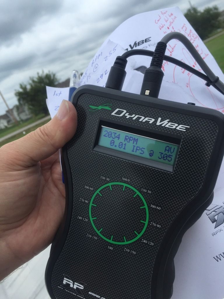

Not so fast, cowling and plenum back off for my first experience with a prop balance, you can see the sensors mounted on top of the engine. These are just my novice observations about the balance.
It took a wider piece of reflective tape for the sensor to see the reflective tape on the back of the prop, thinking the steeper blade angle of the Catto might have something to do with it. The airplane has alsways felt really smooth, my initial IPS (inches per second) was .15. The 255 was the degrees from the reflective tape in the direction of prop rotation marking the heavy spot, so move 180 degrees from that spot and add a large -4 area washer to the ring gear support. I googled that most aircraft have initial IPS in the .4-.8 range prior to balancing, I also had to google IPS...
2nd run showed the IPS lower and the degrees shifted slightly so we know we were adding weight to the right spot. If the degrees shift a lot the weight is too much or in the wrong spot. 4 runs total with another large washer and a small washer left an IPS of .01, time for one more run with a thin washer....or just leave well enough alone.
Thanks for the prop balance rdoerr01, she's smoother than ever!

Posts: 2,400
Just under 2100 RPM is all I can get static, so that's what we went with.

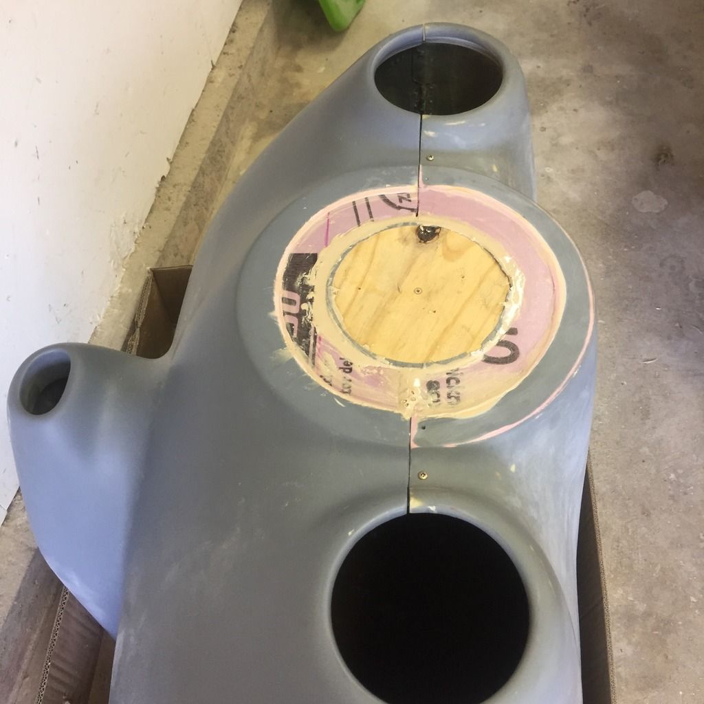

I decided to start sealing behind the spinner, pink foam cut out with a jig saw and epoxy/micro'ed onto the cowl. Im making the front hole behind the spinner smaller and adding a 90* flange with 1/2" clearance from the prop spacer. I'm thinking I can make the seal with 1/2 foam weatherstripping from the cowl flange to the prop spacer or some rubber baffle material from the cowl flange to the ring gear support.
True-ing up the front hole with a 7 inch circle routed from a 2x10.
