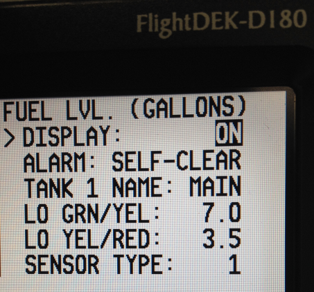

I have dual screen Dynon D180 and D100 in my RV-12. I just recently recalibrated my fuel quantity gage per Dynon instructions. Now I notice that I no longer get a yellow box around the digital number of gallons remaining at 7, nor do I get a red box (steady or blinking) around the digital number of gallons remaining at 3.5. This used to work fine and I would also get warning on bottom of screen which needed acknowledgement.
I have contacted Dynon and they tell me that the unit they have on bench does exact same thing. They were a little surprised and don't have a solution.
Anybody else having this problem?

Maybe change that 7 and 3.5 to something else,now that you have re calibrated sensor, then you can move both back to 7 and 3.5 . Thinking that the re calibration may have voided those original limits for red and yellow. Just a shot in the dark

Probably unrelated, but do you have 2 fuel pressure readings?
I'm not following your question. The screen shot in my first post is the EMS screen and I guess it shows fuel pressure in two locations. Fuel quantity is also shown in two locations on the same screen.
I thought if during your recalibrating of your fuel level, perhaps you erred in some way, ie 2 indications of fuel pressure, one beneath the oil temp indicator, and one in the lower right of screen.

I contacted Dynon about my D-180 fuel gage problem (see post #1 above) and they tell me none of the software engineers who designed the D-180 are working at Dynon on anymore. Dynon also tells me they have powered up several more D-180's in-house and none of them have the yellow/red boxes around the digital number for gallons remaining in tank.
So, maybe I don't remember this correctly... Can anyone verify that they see yellow square and red square & red square blinking around gallons remaining digital number for a D-180? Also, do you get visual warning on bottom of screen for minimal gallons remaining (in my case - 4 gallons)? And while we're at it... do you get audible low fuel warning in your headset?

I ran my right tank low in my 8. My D180 goes green, yellow, red flashing, with audible and visual screen flashes.

Thanks guys. Today Dynon said they got their in-house D-180 fuel gage working correctly by re-loading Van's locked settings file. I'm going to put this task off until end of flying season. Good to know there's a fix...
