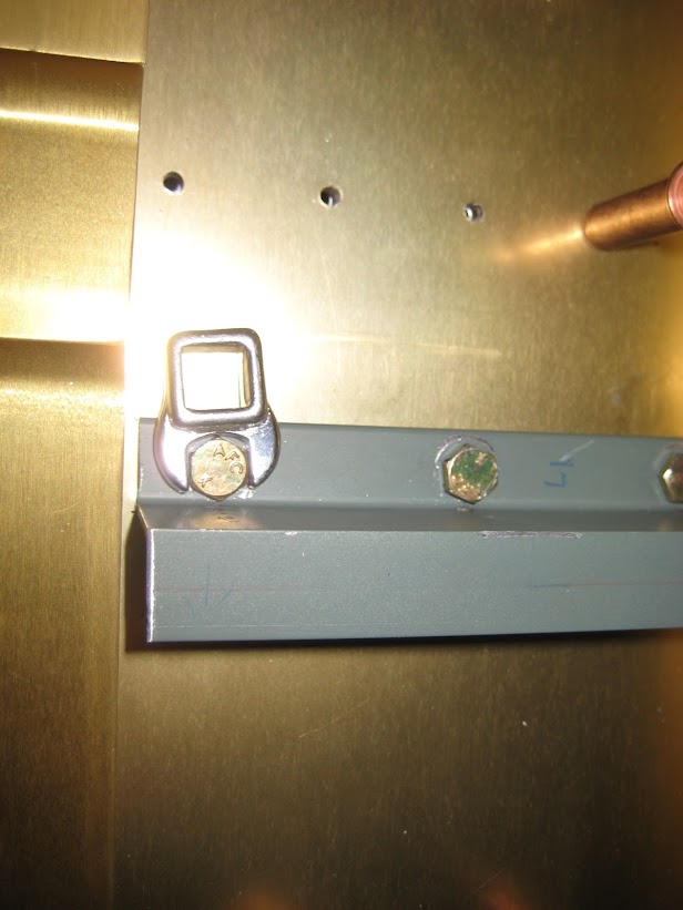

I am working on the Z brackets and they all seem to be ok except for the inboard most bracket on the left wing. I didn't get one of the holes perfectly centered(far right of the picture) and now I can't get a socket on the head but I can turn it with a standard box end wrench. Will that be enough to secure the bolt? If not should I stretch the hole, remake a z bracket?

If you can't get a socket on it but you can get a wrench on it, I assume your concern is not being able to torque it properly? If that is correct, you should be able to do it by feel. Put your wrench on one of the others, feel how tight it is and approximately match that. Pretty scientific, I know.
Another option would be to get you some crows foot wrenches and put them at the end of the torque wrench. Problem solved. These will come in handy other places in the build. Wish I had some!

Just guessing here but if you have a cheap socket it might be that that wall thickness is is the culprit. Grind the wall of the socket down or get a better quality, thinner wall socket?? Larry

I don't want to change any of that hardware, it would be worth it to remake the piece to keep it standard.
I considered grinding down a socket, but the clearance just isn't there.
I tried a crow foot, the one in the picture below is not the correct size(metric) but the tool in the correct size will work. I think I am going to go that route if I don't remake the part.
In theory I shouldn't need to take that bolt out unless I have to remove a tank and that hopefully isn't something that happens on a regular basis.

hi aaron, we are doing a 9a and couldn't get a socket on any of them. well, we could for a little of the way but then pulled it off and used a wrench for the rest. i just pulled my tank back off the spar and it was pretty quick. i too wondered about making a socket but the open wrench was just fine.
