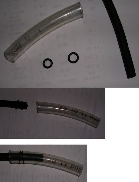

I made adaptors out of 3/8" ID plastic tubing and "O" rings. The 3/8" plastic tube slides over the 90? male fitting on the intake manifold. Simple and cheap. Actually free because I had the parts.
Using a hinge and cardboard, I made a bracket to hold the CarbMate to the firewall hinge so that I could see the CarbMate from inside of the cockpit. It takes time to start the engine, look at the CarbMate, shut off the engine, adjust the throttle cable, and repeat. But one person alone can balance the carbs without standing next to a moving prop.
