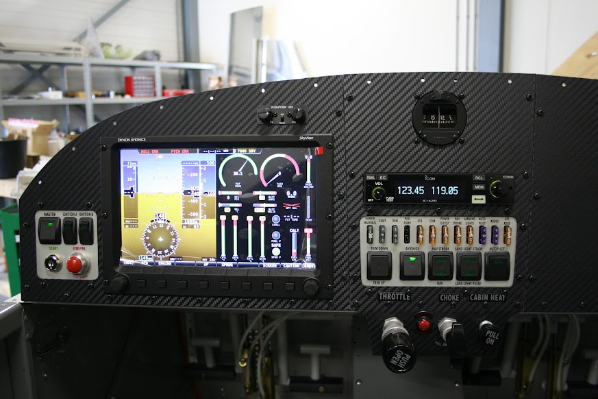

all,
tired of having ordered the wrong type of screws again I ask you for your help.
I just can' t get used to US metrics, so it seems ;-(
What is the size of the phillips screws the avionics panel is mounted with on the top-side, please?
(meaning the inside panel, where the avionics is attached to)
Hans Labruyere

The screws around the panel are #6 countersunk in a genuie RV-12iS. In my case non countersunk.
Also, you can find a thread here at VAF with a source für nice stainless screws with Torx drive and 100deg coutersunk. They are great but shipping is more expensive.

I replaced the original instrument panel screws with MS35206-228 Steel Pan
Head Phillips Screws, 6-32 Thread Size, 3/8" Long. The pan head is much more
resistant to stripping out with a Philips screwdriver than the original screws.

Not sure if there are other thread standards for #6 screws, but our planes use 6-32 with 32 threads per inch. That bit me once buying some 1/4” hardware. I ended up with coarse threads and needed fine threads.

I used black AN515B6R8 PHILLIPS screw from aircraft spruce
(the same screws are used for the rest of the panel)
