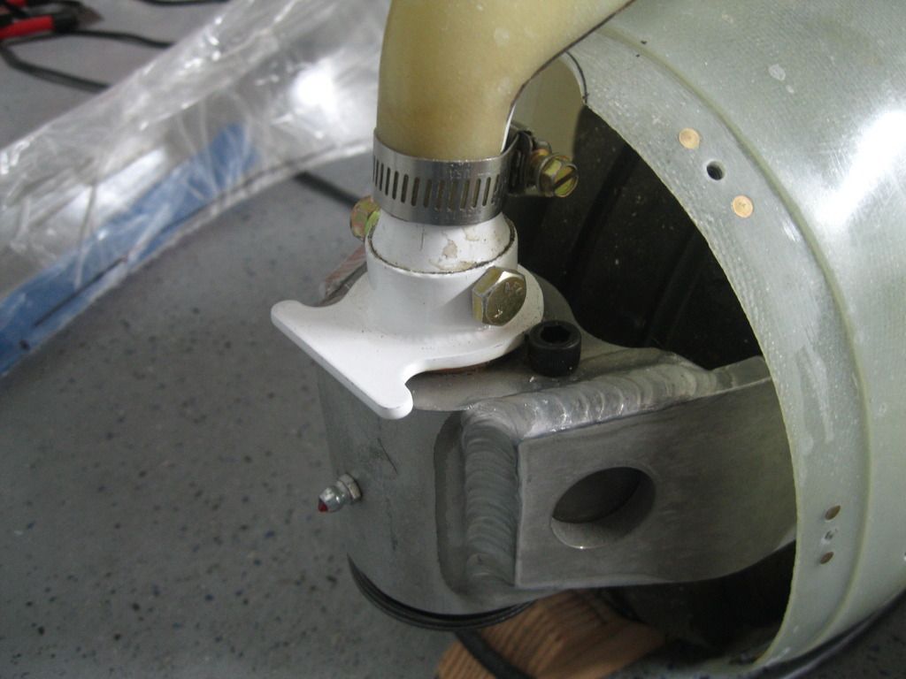

Becoming more familiar with my newly acquired RV9A. Yesterday, in gently pushing the aircraft backwards without using the tow bar, nose wheel rotated a full 180 degrees and I could make it rotate 360 degrees with no apparent stops or indents. In speaking with two different RV owners, one says this is "normal" the other says it sounds like I'm missing a part called a "nose wheel stop." Any feedback would be appreciated.

You are missing two cap screw stops.

Check your Service Bulletins at Van's. There is a recent one for the nose stop flange installation.
http://vansaircraft.com/pdf/sb14-12-22.pdf

Hey Curt,
Here's what it looks like, correctly installed. The Allen cap screws serve as the stops. As referenced by the service bulletin that Bruce posted, they are often installed backward, with the ears pointing aft.

Pierre brings up something I hadn't thought about. The damage from installing the stops incorrectly occur from the forces of the incorrect geometry of the stops. What are the risks of no stops? Lets assume the prop clears the tail end of the wheel pant.

That prop comes really close to the wheel pants if not actually hitting it. If you are not paying attention like at a quick fuel stop and then pushing back to get out of someone's way the damage could happen very fast. And be expensive.
It's amazing how distractions can happen when least expected.
