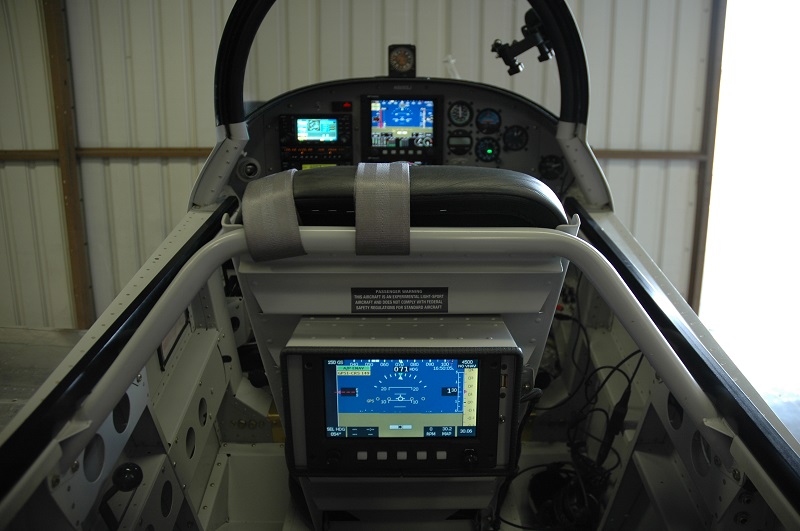

I've never have someone complain about getting a ride in the back seat of my -8, and I've had quite a few passengers. Most comment how great the visibility is. My 25,000 hour 6'2" 82 year old Dad has probably spent a couple hundred hours back there, and my SO nearly as much. Here are some of my passengers enjoying the ride:

Back Seat
