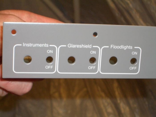

I want to revise the placard that I have here but I'm not sure where to source it from. Any suggestions?
Go to a local trophy shop with your design. Most of them can do a real good job for a very reasonable price.

I used the dry transfer method on the last but one panel I did.
Surface prepped the aluminium panel with a light sanding, wiped with acetone, used a couple coats of primer surfacer with a light sanding then 3 or 4 coats of light grey and sanded dead smooth. Waited a few days to ensure paint was proper hard, then rubbed on the lettering. Followed that up with several coats of satin clear without sanding in between coats, then sanded, and a final coat of satin.
Looked gorgeous.
Its about impossible to change anything without completely starting over or it'll look like ****, but if you get it right its lovely.

I love the dry-transfer label though. I did mine with a flat 2k clear. Zero glare, super easy to read. No complaints at all.
