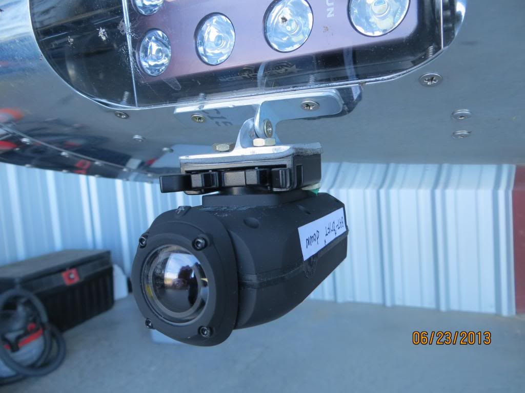

Default Mounting for Drift HD Camera on RV-12
This is a quick detach mounting for a Drift HD camera, mounted to the bottom of the wing on our RV-12. Rather than leave it on Video, I normally set it to take a picture every 10 seconds. My longest flight so far with the camera on was 2 1/2 hours. The battery lasted the whole time and it took over 900 pictures. We then download them to a computer and only save the best ones. By the way, this location for the camera keeps the propeller out of camera range.
This is a picture taken by the Drift Camera while I flew over the White Cliffs area of the Missouri River in Montana.

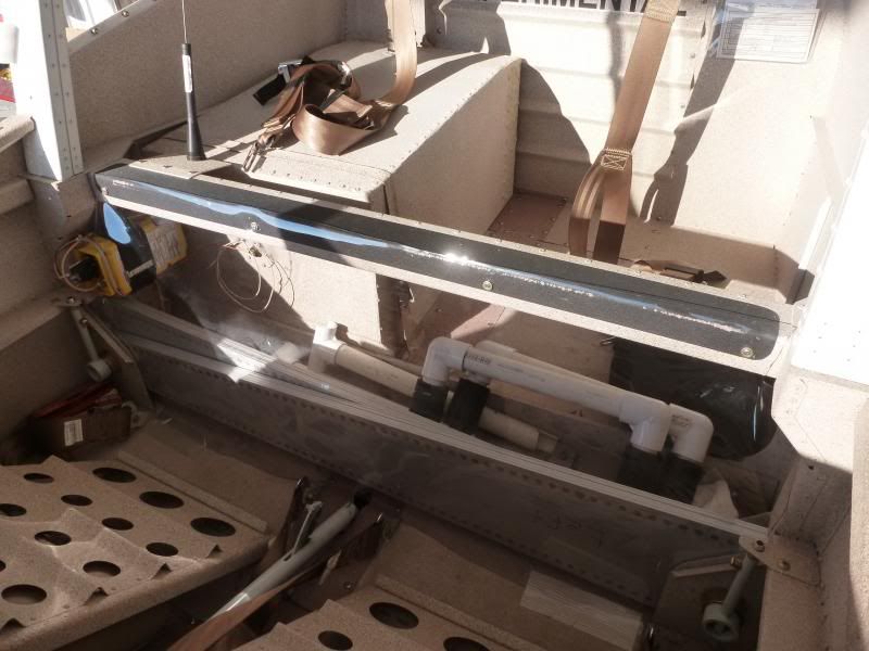

Default COLD AIR CURTAIN - -
I feel cold air coming forward from between the seats when cold weather. I have used a beach towel accross this same area, but I had this flexible, clear, vinyl, and cut it to fit. I put 4 rivets with washers to hold it in place. Could use screws. Can barely see it, so this angle reflects it some. I used shipping tape on each side to seal to floor. Can take it out in 2 minutes if needed. Might just leave it there except when tank needs to come out.
John Bender
