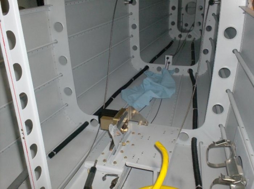

My GTX 23ES is likewise mounted behind the baggage bulkhead on the AHRS shelf Van's sells vs the ELT bracket. That places the unit to left of and behind the battery. The antenna is immediately behind the baggage bulkhead on the tailcone bottom, right of center-line. Works just fine (passed both the Avionics shop cert and FAA ADS-D inflight check).
In the pic below the end of the yellow battery cable is over the shelf in question.
