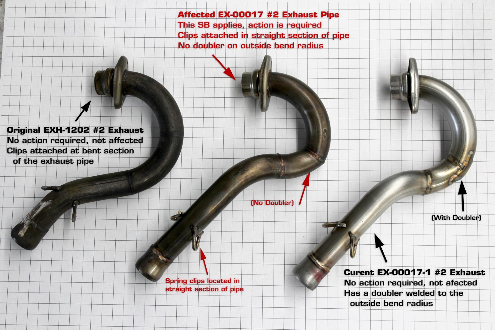

Document Name: Service Bulletin SB 19-03-22
Effective: May 21, 2019
Subject: Cracking of the EX-00017 Cylinder #2 Exhaust
Affected Models: RV-12 with 912 ULS engines
Affected Serial Numbers: All RV-12 model aircraft (RV-12iS is not affected)
Required Action: Inspect the EX-00017 Cylinder #2 exhaust tube for cracks as described in this document. If cracks are found, replace the EX-00017 with an EX-00017-1.
Van’s Aircraft has released a Service Bulletin (SB 19-03-22) affecting all RV-12 aircraft equipped with a Rotax 912 ULS engine and a specific configuration/version of the Cylinder #2 exhaust pipe. Depending on when the RV-12 firewall-forward kit was produced, there are three possible designs for the Cylinder #2 Exhaust Tube. Only one of those designs (EX-00017) is affected by the service bulletin. Inspection is required in order to determine which specific part is installed on an individual aircraft.
Data from the field suggests that some EX-00017 Cylinder #2 Exhaust Tubes are prone to fatigue cracking. If the pipe fails, hot gases from the exhaust may eventually compromise the composite cabin heat duct, which could in turn result in the introduction of dangerous exhaust gases into the cabin if the cabin heat door was open. Complying with this service bulletin will ensure aircraft equipped with affected parts are furnished with a sufficiently robust part, equivalent to aircraft equipped with newer parts.
Before further flight, owners are instructed to inspect their aircraft to determine which part is installed, and in cases where the affected part is installed to either replace the part with a new part available from Van’s Aircraft or to equip the aircraft with a carbon monoxide detector and then inspect the affected part at regular intervals. If a cracked pipe is found, the new part must be acquired and installed. Note that once a crack develops in the affected part, it is likely the exhaust pipe will fail quickly. Therefore, regardless of whether any cracks are observed, Van’s Aircraft recommends that any affected part be replaced proactively, to avoid the possibility of a crack-related failure. The use of an aviation-grade carbon monoxide detector prior to replacement is an option, but should not be considered a long-term solution.
Photos of the affected part are included in the service bulletin document, in order to aid in identification and to help determine whether or not the installed part is the one covered by this bulletin.

That point was raised a couple of times this week in discussions with customers about this SB. We probably should have stated in our initial post here that Van’s is providing this part, which is somewhat complex and labor intensive to manufacture, at-cost to owners who are replacing affected parts.
A couple other questions we've answered this week:
Q: Have there been actual cracks of this pipe occur in the real world?
A: Yes, on at least two occasions we have observed a failure of this exhaust pipe section, which resulted in burn damage to the engine cowl at the air inlet tunnel, which provides cabin heat.
Q:What’s the worst thing that could happen if this pipe fails?
A: Failure of the exhaust pipe could result in hot exhaust gases eventually burning through the air inlet duct in the cowl, which would result in the introduction of exhaust gases and carbon monoxide into the air inlet duct, and potentially in turn into the cabin of the aircraft where it could affect occupants.
Personal statement, made as an individual: I happened to be the pilot of an RV-12 in one of the two occasions mentioned in the above above point (this was not one of the company-owned airplanes). I was able to recognize the occurrence of the failure, determine what was likely happening, and get the airplane safely on the ground before things got too much worse. I did have to repair the fiberglass cowl/duct in that case and the inlet duct material, although substantially heat damaged, had not burned all the way through. That said, had I not recognized the occurrence in a timely enough manner, the outcome could have been different. So, from personal experience I'd suggest - as an individual aircraft operator and pilot - that a taking the proactive approach on this (replacing the affected part) is in my opinion a smart, reasonable and relatively small price to pay. Heck, you don't even want to know how many AMU's it cost me a couple years ago to replace an exhaust section that had failed on the certified spam-can aircraft I owned! And, I replaced that same part twice in a 10 year period! I'm still trying to wipe those expenses from my memory!

Do not wrap the RV-12 exhaust. It's not manufactured not intended for that. And, it would have no impact related to the issue described in the SB, other than to make it basically impossible to examine the pipe itself.
