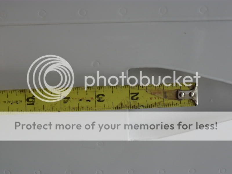

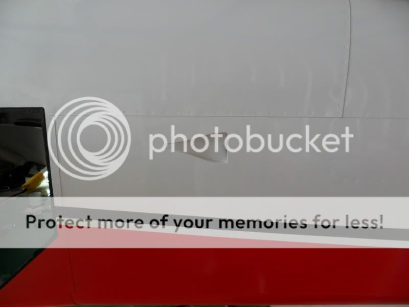

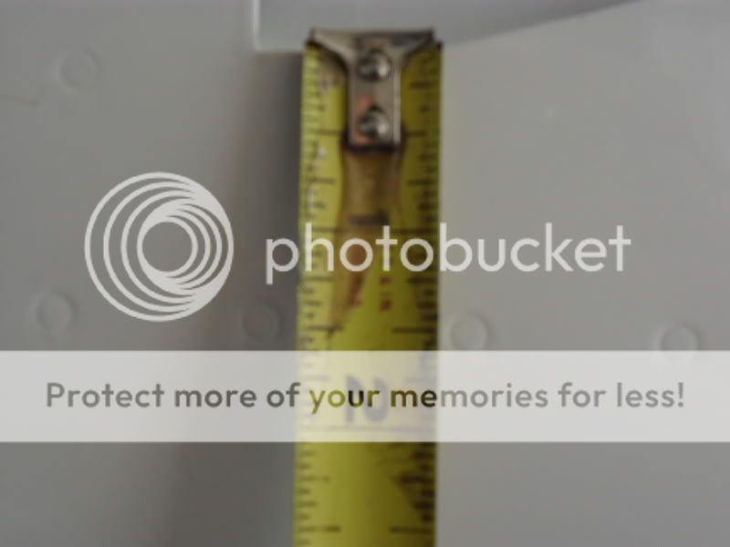

Would one of you guys that has the rear naca vents installed mind posting a picture of the location?
Here's mine, which are in the same location that Bob Condrey described is were. I know that Geoff and several other's are centered on that panel. It doesn't seem to make a difference, so pick the spot that looks the best to you.
