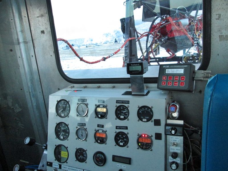

Default Aerosport 375XP SDS EFI
I was out in Kamloops at Aerosport this week, hooking up and running a 375ci clone with our SDS EM-5 EFI/EI setup.
Learned a few new things here which we can apply to improving our product and making the process more seamless for our customers. Fired right up the first time with the base mapping. Got the values tweaked up for the extra cubes. Exceptional idle quality right down to 500 rpm.
Great bunch of people at Aerosport to work with. Nice to get away from our shop/ business for a couple days to play with engines and hang out with engine guys, trading stories.

what no power numbers....nice tease

Not teasing. No dyno in this case, just running on one of the test stands.

just poking fun. Good looking engine

Yes, Aerosport details and paints their engines very nicely. A lot of pride and care goes into their offerings. This particular engine was built up custom with EFI/EI in mind as it has a lightweight accessory cover with no provision for mounting mags at all.

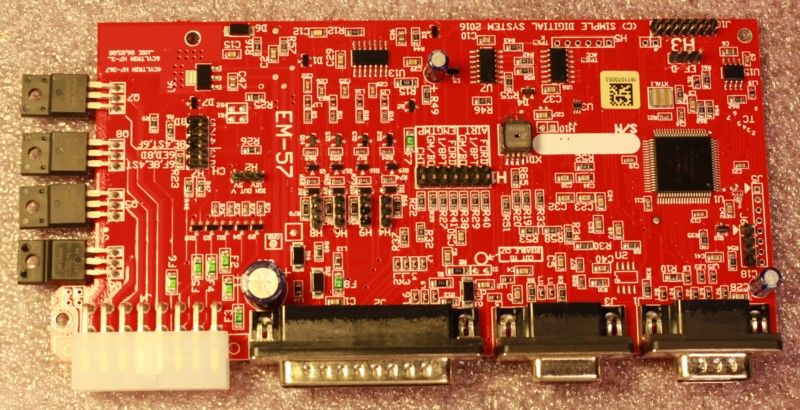

Default EM-57
I see V29 software for the EM-5 includes a LOP fuel trim coupled to switched control of the advance map. If I understand correctly, the user can set up a fuel flow and ignition advance schedule for best power operation, a preset additional leaning percentage to accompany more advance for LOP operation, and transition between the two schedules with a single switch flip.
Looks like a gross trim function, i.e. lean all injectors by the same percentage for the LOP schedule. At the practical level, is it working well across all likely cruise MP and RPM settings, or do the EGT spreads vary at different power settings?
More sensible incremental progress. Nice work Ross.
Thanks Dan.
Yes, this feature was suggested by users regularly flying LOP at similar power settings and altitudes. Once set up, this feature allows a very quick transition to LOP plus adds your preset ignition advance to bring back some of the lost power due to the lean mixture. You may then tweak your fuel trims to even out each cylinder's EGTs. We've placed some software MAP limits in here to prevent the ignition advance part from happening at the wrong time to help avoid inadvertent operation in the "Red Zone".
Shipping now are the new EM-57 boards which have on-PCB barometric sensors (no more daughter boards) and V 29.1 software which has more advanced setup modes for temp sensor pairing plus improved MAP sensor accuracy. There is also a new header strip for future connection possibilities into the CPU. Boards are also now machine conformal coated vs. hand done as before. This gives more consistent coverage for improved moisture/ humidity protection. Our military customers like this advance so we've just done it across the entire line as it's just easier during production and gives all users a higher quality product.
