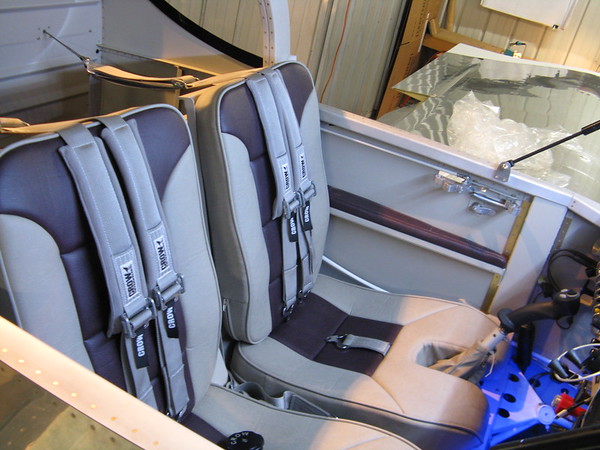

My Classic Aero Ultraleather seats show virtually no wear after 350 hrs/3 yrs. One of the seat heaters failed after about 100 hrs, and replaced at no charge.
https://i.postimg.cc/4dgRZNJv/2353-lrg.jpg
