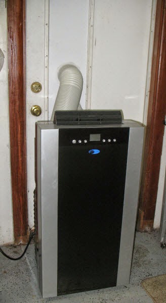

Default Air Conditioning and Heat
I've gone back-and-forth on this one, and finally decided on a portable unit rather than messing with the air handler in the garage.
Insulating the attic seems to have paid off as this morning it is 37 degrees outside but 62 degrees in the garage/workshop.
After a lot of research (of course!) I purchased the Whynter ARC-14SH portable air conditioner/heater. It's rated to handle 500sf of space and that's right about where I'm at.
I removed a window from a side door and replaced with a mount I fabricated for the intake and exhaust hoses. It really hasn't been fully tested yet and think that will come during the summer when it's 98 degrees with 98% humidity.
