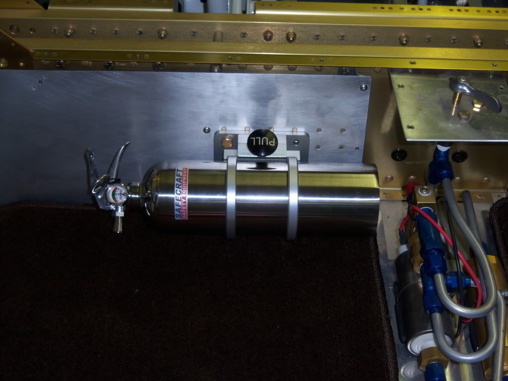

Default right side forward of the spar
[IMG][/IMG]

Anyone tried on top of the fuelpump-cover?
That's where I'm considering. Any good reasons not to use that position?
Wherever it goes, for me the dictating factor has to be that the pilot can reach it and remove it for use in flight without having to undo or adjust his seat belt. If you have an inflight fire and you're doing a fast emergency landing, the last thing you want to be doing is messing around with your seat belt.
Placing it on the front of the spar wasn't an option for me because I have a 7A and the gear leg mount doesn't leave enough room for an extinguisher in that location.
Richards' point about not leaving the extinguisher in direct sunlight is a valid comment but I'm hopeful my Kroger sunshade will do the trick when I don't have the canopy cover on.

I mounted mine on the fuel pump cover.
Similar positioning for mine. Link to image
However, I wanted to make a different point about the actual fire extenguisher itself. You can see the black plastic top to mine (via the image link), vs the metal top in Daryls image. GET THE METAL TOP. My plastic one pops off if I so much as LOOK at it sideways. The neck support in the bracket actually causes it to come off too. Annoying and obviously not good for quick use in emergency. POS
