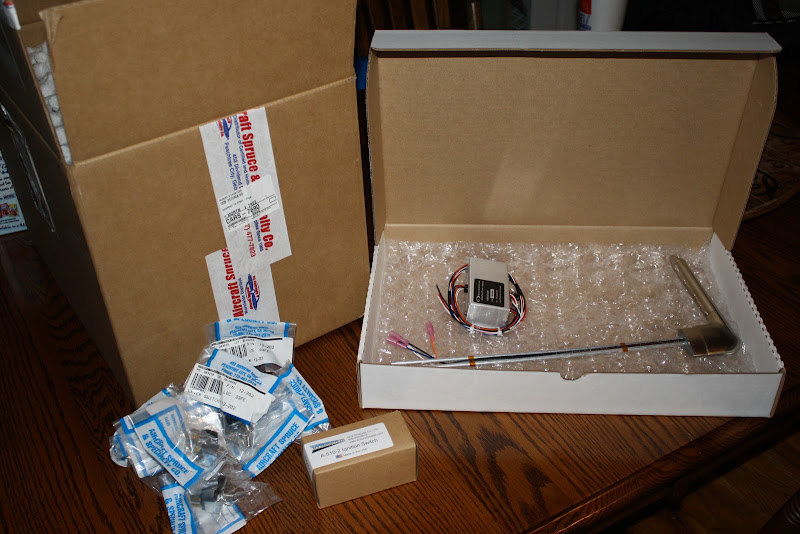

When I got home, I found some of the supplies I ordered have arrived. I normally order all the things I can from Stein but I wanted an ACS key switch and needed an oil filter cutter so I added some stuff to the order to get free shipping:
Ironic that all of the older Dynon stuff is going out but yet something new from Dynon is going in....
The majority of the wiring supplies are due in from Stein tomorrow. The VP-X Pro is due in on Tuesday of next week.
