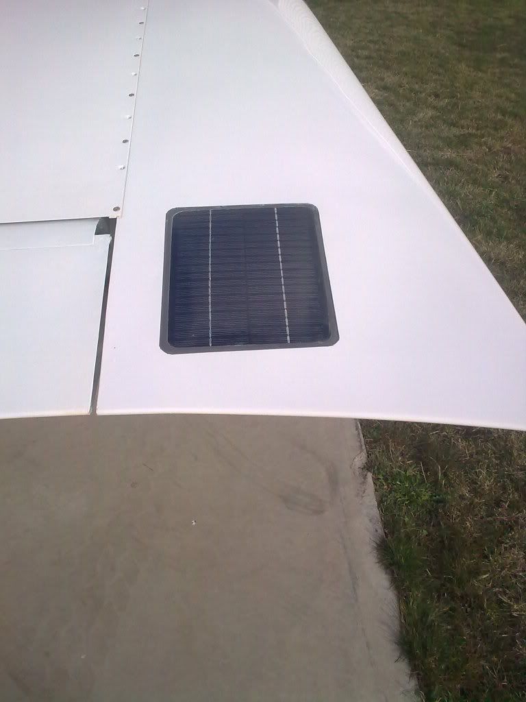

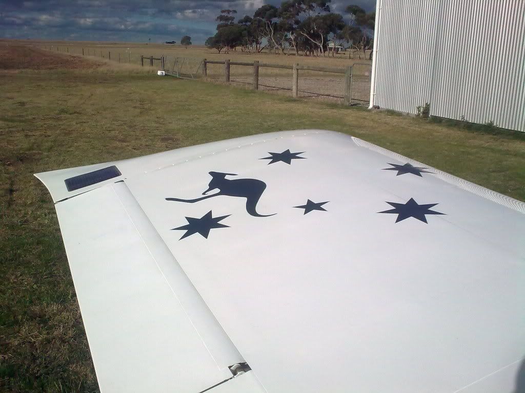

I built in two solar panels into the wing tips. They are only 1/4" thick and produce around 800millamps when the plane is parked outside. When parked in the hanger they only produce around 20millamps. They weigh next to nothing as there is no glass but are covered in clear epoxy.

They are only Prosealed into a recessed housing. To replace them should be easy, and because I didn't paint the Proseal there is no paint needed.
