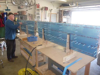

3 more hours in today!
I didn't work on the plane at all yesterday. It was just one of those days. Bad night sleep the night before, nothing went right at work, I sliced a chunk of skin off my thumb changing the air filter in my car, I was in a bad mood... and I just knew I would mess something up.
So I had a nice dinner and had a relaxing night. Just what I needed.
Today, though, I was able to get the final drilling done on the HS, and I replaced some rivets on the spar doubler that had tipped heads. It was a beautiful weather (80 in Minnesota in March), my dad was able to come out and help with the drilling, and just an all around good day.
The old man putting in some time
The remains of the tipped rivets that were removed
Next I get to do a whole lotta deburring...

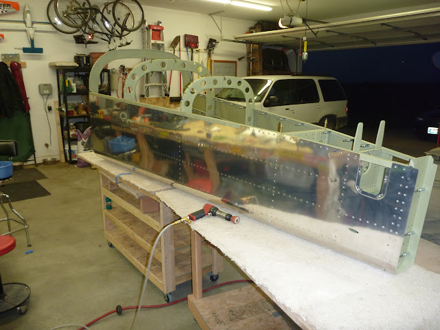

I have begun riveting up the tail cone. So far, so good... I've been back-riveting as much as possible, and it's been working well.
