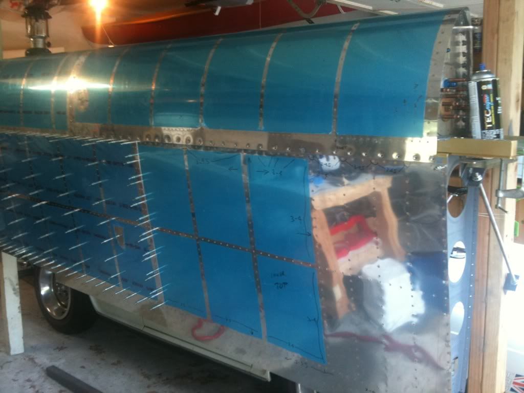

Think I'll rig up some means of holding back the skin and dive in!
Gotta got-er-done! I want to final mount my wings, fill the tanks and get on toward first engine run!
The project has had a low priority for the past year but I'm ramping it back up.
Thanks again.

I just finished my slow build wing and I can't imagine setting those rivets without help. Even if you do I'm pretty sure you'll be happier with the end result if you get some assistance. I always let my less experienced helpers use the rivet gun; I feel the talent is on the bucking bar end.
Here's one of my helpers (daughter).
None of my helpers had ever held a rivet gun before and I couldn't be happier with the results.

... is to get help with the rivets in the rear spar and then up each rib about 4 or 5 rivets. After that, you can reach the remaining ones solo and without shredding your arm or contorting like a pretzel. That way your helper doesn't have to spend half a day. That's what I did and it worked fine. MUCH easier than trying to reach those furthest ones yourself.

I am about 25 % through doing bottom skins. They are in a wing craddle with leading edge down. You are right, it is tough. I have forearms that don't fit well through the lightening holes, so it "leaves a mark". It is possible to do, and I am getting better as I go along. I have a couple skin dents from my bucking bar slipping, and if anyone knows how to refurbish these types of mess-ups.....would be appreciated.
I try and get one or two bays done a night...

A long sleeve shirt or thin fleece is what I use... will help save your arms from scratches and bruises when you reach through lightening holes. the fleece hangs up on the edges and your arm slides right through unscathed.

You can do it. Some work from spar aft & some work outboard. That works best for me. You have a curl of skin going over your shoulder and keep as many clecos as you can between your face and your hands without kinking the skin. I use a 4X gun and hold it around the barrel. Work the trigger with the web of my thumb...thump...thump....thump.
This is what I used in the USAF, and have one in my tool box.......
http://www.browntool.com/Default.asp...ProductID=2176
It is great for working alone.

1 down 1 to go!
Making some progress thanks to tips from you guys.
Had help offers from Jerry and Craig but I couldn't nail down any times when I knew for sure I'd be able to work on the plane.
Thanks alot guys! The offer means a lot! This is a great meeting place.
