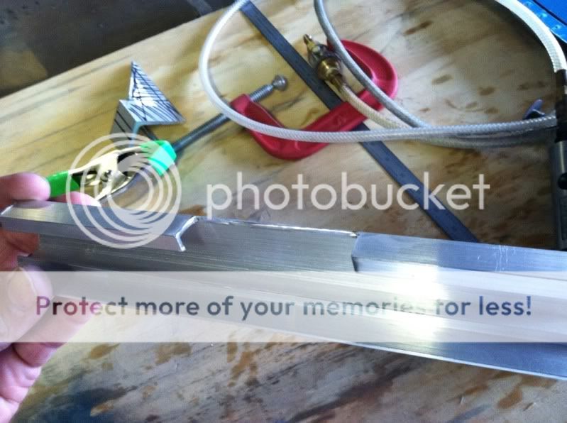

I’ve spent some time trying to figure out a simple (USMC style) solution to this problem. My desire was to have something quick and natural, something you do every time you exit the aircraft.

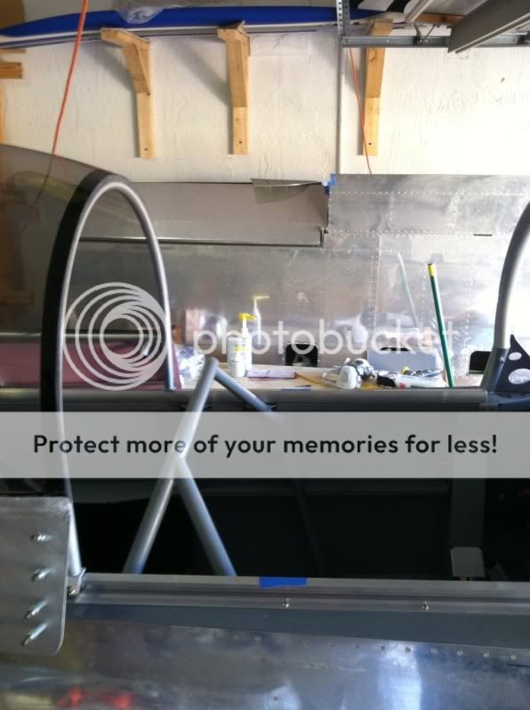

RV-8/8A factor: The “cool” things about the RV8 canopy system. I want to be able to open the canopy 3-4 inches in flight (Florida heat) and taxi with the “Cool-guy arm on the rail”. I won’t make excuses, I want to look cool! With that in mind I made sure these two factors were retained.

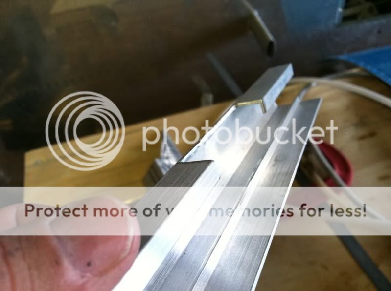

I plan on cutting out 3 inches (3x roller diameter) of the roller track’s upper cap. Approximately 15 inches and extending to 18 inches behind the front canopy bow. This was determined for me personally using seat back rest and leading edge of my shoulders. I place the cut-out before the shoulder because of “cool-guy arm” position would dictate canopy locked into position behind shoulder. This cut-out position also gives a 10+ inch buffer behind my inflight open canopy position. Should the canopy somehow become unlocked from the inflight position, the downward and forward air pressure on the canopy would have a margin for ????.
The only other player would be on the ground while loading people. I think we can all agree that gravity will retain the roller for 3 inches while traveling forward-rear-forward.

These are some rough cut up scrap. Final product would have nice rounded edges and look better.
Maintaining the structural form
Blue tape is position of my cuts (determined by pilots shoulder+seatback)

I like your idea. The only risk I can see is maybe normal ops on the ground in heavy winds. If a gust caught the canopy as it was transitioning the 'gap' in the tracks it might make an unplanned departure - probably a remote possibility.
I have the pins in mine, and they are definitely not a perfect solution. I don't mind flying with them out, but I fear I'll forget them and damage my canopy (same wind gust or prop blast scenario) on the ground with it open or partially open.

I would think that you would be better off with the opening at the front of the rail. That way, you will have help holding it down with the windscreen fairing (canopy slides under) and being at the first part of travel you will have your hands on it to open so won't have to worry about any gusts while on the ground. Also less time to open in emergency, just clear the windscreen fairing, which is just shy of 1/2" on mine.
Whatever you choose it would be good idea to mark the area in red, visible to thhe pilot from inside to know where it is.

I could be wrong, but it appears that the aluminum that you're using is the hardware store variety. If that's the case, you should be aware that there's a big difference in strength between aircraft alloys and what might be used to frame a screen door. Most wrought aircraft product goes thru some sort of secondary heat treat process and also is typically formed with fillets and radii.
If it isn't aircraft grade, DON'T USE IT. Certainly not to help hold on your canopy.
