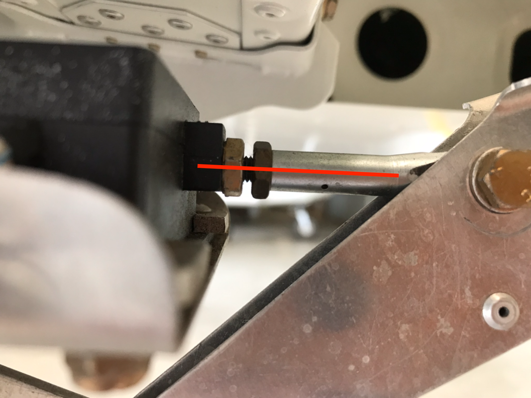

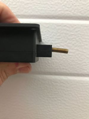

If I may make a point here: To state it plainly and simply, this is exactly why we published the Service Directive. The photos show a pre-failure condition. It's not possible to say how long the unit might take to fail, nor is it possible to say why your servo is in this condition, but this condition is exactly what was predicted and is the first step in the potential series of failure events that caused us to decide to take action. In the safety and risk management world, we call your investigation and discovery a success - It's the SD process working as a preventative measure.
In case people don't take these notifications seriously, this is a great example of why it's important to stay up to date on your service notifications (for any airplane type, not just ours). I'm posting Bob's photos inline here just to make them easier for folks to see. They are good visual examples.

Done. And here are photos for any of you that might be interested.
I have looked at your pictures. Your servo and bracket appear clean and maybe lowTT.
How many hours on the airframe?
Any idea how servo rod got bent? Rough ground handling perhaps?
Yes, low TT - about 18 hours. Too bad this SD didn't come out a couple of months earlier, as it would provide more data to analyze this issue. Unfortunately, early April I disassembled the plane for painting. I picked-up the actuator assy. from the painter yesterday to address the SD since it was apart. This was how I found it when I picked it up. So, I can not confirm if it was this way when I removed it from the aircraft. For that matter, this was so discrete of a discrepancy that, for all I know, this could have been bent the day I installed it. Face it, it's been sitting around over two years waiting to be installed, and I could have even bent it day one when I snugged up the jam nut. I just can't say.
I am PRETTY sure the pivot point wasn't contacting the bottom of the tail fairing and that my hole was large enough. And I can guarantee the AST dimensions specified in the PAP were right within range before first flight. Again, this was so discrete of an issue that even if I was doing an inspection it's very likely I would have missed it.
So, yes, it could have been that way from day one, but I believe the take away from this discussion is that it's an issue that can occur.

I read SD 00001 and pulled tail cone fairings off to inspect. My threaded shaft is perfectly straight at 536TT. Early-on I added a 2nd jam nut to lock the threaded shaft to the square servo actuator. So, I will following the SD and monitor shaft for straightness thru 1000 hours of operation.
I'm wondering if threads are rolled or cut? AN hardware uses rolled threads to prevent stress concentration.

Jim, I know you weren?t the original builder, but see step 2 on page 8 of the original KAI section 11.
https://www.dropbox.com/s/jvj8ysixx3...ttach.pdf?dl=0
This step covers adjusting the aft end of the servo push rod. You?ve got a lot more thread exposed between the rod end yoke and the plastic shoulder of the servo drive rod than I, so would expect yours to be more prone to bending. But the kinematics of that appear to indicate that your pivot point would not drop as low as mine when the rod was fully retracted, thus be less likely to bottom out on the tail fairing than mine. Making me wonder now if I was in fact contacting the bottom of the fairing? Just another observation. I?ll certainly be very watchful of this area when the plane is reassembled.

Yes, I'm aware of KAI section 11. I elected to add the 2nd jam nut to prevent rotation, vibration, and working of thread in the square actuator. I never run servo to limits - so no jamming at control stops. I have checked trim function apprx 50% more travel up/dwn than used in flight.
I'll keep "tab" on the tab until 1000TT...

When I looked from the side it appears to be not bent.
Took it off and WOW it is really bent
166 hrs
