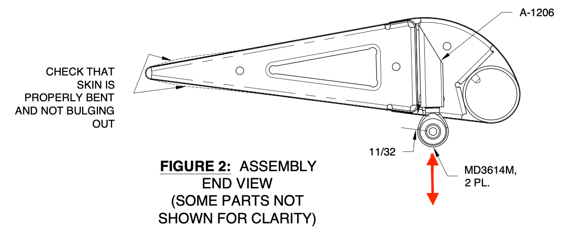

Just getting my rv12 in the air after 4 years. I have an issue of it rolling to the right. Not noticeable at pattern speeds, but requires a fair amount of left force at cruising. I have tried 'pinching' the left aileron of couple of times. No help. Should I be adjusting the ailerons? High wing up or low wing down?

Adjusting ailerons up or down won?t help. They?ll just equilibrate in flight. Something more subtle. Check angle of attack both sides, compare aileron hinge lines?vertical heights, ...

I bought my 12 from original owner with 48TT. The airplane had a small trim tab fastened to the left flaperon with double-sided tape. It worked but the trim tab looked obnoxious and tape isn’t exactly structural. I removed the trim tab and the plane flew with a very heavy right wing.
I checked and adjusted the straightness of the upper wing skin that trails behind the spar and also squeezed the trailing edge of the flaperons. Neither solution fixed the problem.
What I did find extremely effective was changing the height of the flaperon pivots. Its been several years now, so I can’t remember exact adjustments, but basically what you want to do is raise flaperon pivot on one wing and lower pivot on the other wing. Perhaps start with ½ turn up on right wing and ½ turn down on left wing and test fly. Again, I can’t remember which flaperon I raised and lowered. No big thing – just note the change and test fly. First test flight will tell you if you’re adjusting in correct direction. If wing is heavier in flight then do opposite correction.
I believe I ended up changing pivot heights by one turn of the rod ends. One wing one-turn up and the other wing one-turn down. Plane now flies hands-off and ball is centered in cruise flight. Deploying flaps anywhere in the white arc is still hands-off level flight.

Originally Posted by Piper J3 View Post
I bought my 12 from original owner with 48TT. The airplane had a small trim tab fastened to the left flaperon with double-sided tape. It worked but the trim tab looked obnoxious and tape isn?t exactly structural. I removed the trim tab and the plane flew with a very heavy right wing.
What I did find extremely effective was changing the height of the flaperon pivots. Its been several years now, so I can?t remember exact adjustments, but basically what you want to do is raise flaperon pivot on one wing and lower pivot on the other wing. Perhaps start with ? turn up on right wing and ? turn down on left wing and test fly. Again, I can?t remember which flaperon I raised and lowered. No big thing ? just note the change and test fly. First test flight will tell you if you?re adjusting in correct direction. If wing is heavier in flight then do opposite correction.
+1
Do this. Raising the pivot point makes that wing ?heavier?. It?s pretty sensitive.
