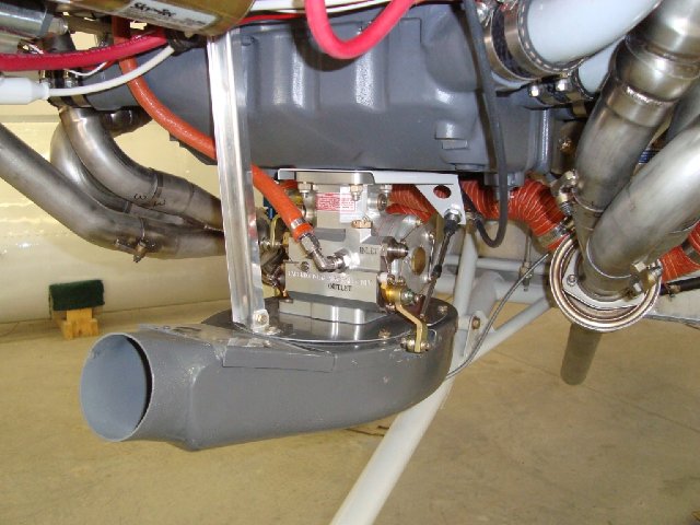

I agree with the above. I have been flying my RV-4 for 20 years and have struggled with shrinking air filter and cracking air bracket. I solved both problems as follows:
I redesigned the air bracket by remolding with fiberglass. I have no metal in the bracket other than nutplates and filter retainers. The input opening to the air induction is round not oval. The opening is only about 2" diameter and I mathematically calculated the inlet flow far in excess of the air requirements.
Nothing on the bracket touches anything on the cowling and does not require any support brackets. A fabricated gasket was made from wet suit material of which I recently replaced. I have flown it for several years and several hundred hours and never have had a single problem. Dave Anders helped me with the design of the inlet taper degree which gives me about 1/2" more manifold pressure than the original bracket. It is a lot stronger and lighter than the original Vans designed bracket.
I am careful about over priming so I don't get any fuel in the air-filter assembly. I drilled a small hole in the bottom aft part of the air filter bracket that drains fuel or any liquid that may get into the filter box area. I don't clean the filter unless I can not see light through it. It stays pretty clean most of the time. I do knock out debris like bugs etc. It does shrink a bit but I simply stretch it back out by grabbing the sides opposite of each other and it returns to the normal dimension.
On inspection, I check the inlet to the engine on the fuel servo and it is always sparkly clean so I figure I must be doing the correct thing as far as filtering the air is concerned.

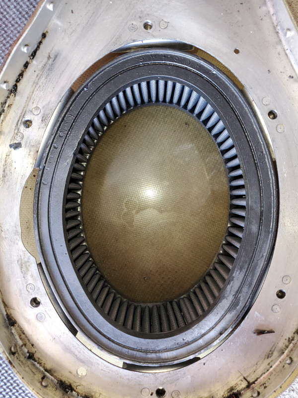

For you RV-10 guys wanting a bigger filter, one option is to replace the standard filter with a taller one, the K&N E-1000. It is taller but same outside diameter.
You take the standard filter box and invert the top. Note the aluminum plate on the bottom of the box with the brackets. This was done to help prevent the filter from going conical.
This was for an RV-10 with a James Cowl and it worked very well. I assume it will work for a stock cowl but don?t know.
