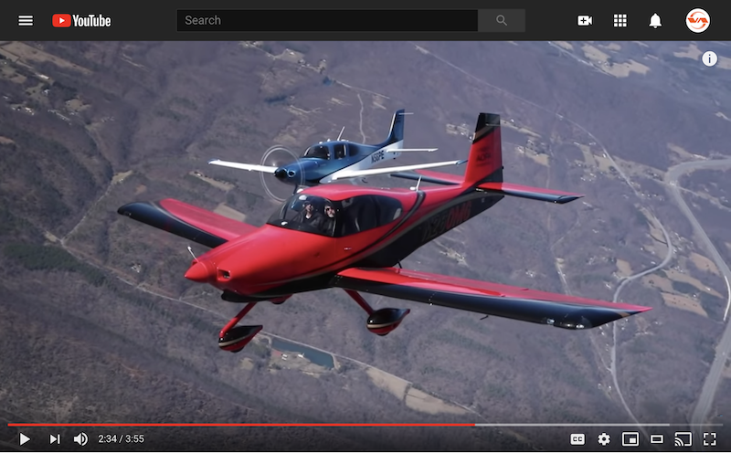

It's been a couple of days since it was published, so maybe you've already seen it - but AOPA did a bit of a fun fly-off drag race between their sweepstakes RV-10 and an SR-22 and posted a video. More details of the comparison will be in the AOPA Pilot magazine per Dave Hirschman from AOPA. Many people are asking the same sorts of questions posted earlier in this thread, of course. Click the image to watch the YouTube video.
