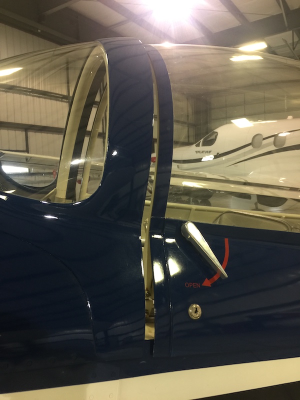

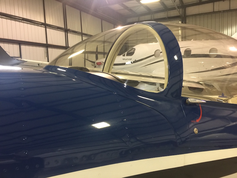

Thanks for the tips on posting pictures. Hope this works. Here are pictures of my 8 windscreen fairing & canopy.
Windscreen SikaFlexed & riveted to fuselage
Windscreen & Canopy
Canopy Latch/Lock
Joggle in canopy to slide under windscreen fairing
Dennis Enns

Very nicely done!! Those are some tight seems. I wonder if the thickness of primer/paint will cause any issues.

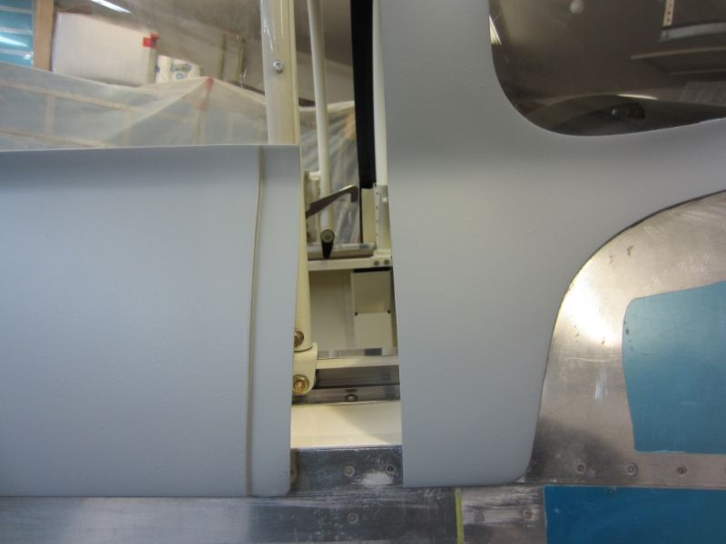

Originally Posted by Champ View Post
I'm a daily follower of VAF and have learned a lot. This is my first crack at a post.
I made the windscreen fairing on my 8 removeable during construction and always intended to blind rivet & Sika it around the leading edge & Sika it over the roll bar. Also considering proseal or G/Flex in place of Sika dependant on a pull test I have yet to do.
Now that it is done and ready to attach I wonder if it would work to screw it to the fuselage using nutplates and attach it to the roll bar with the same screws ( longer) that attach the plexi - with caulk in between to make it water tight. This would make the windscreen relatively easy to remove.
A VAF search turned up a good thread on metal fairings and one FG fairing built as a separate part but did not show the final result.
Has anyone else done this? Is it safe? Does it look OK? - CS fasteners would show - pictures would be great. At this stage it is just as easy to screw it as glue it. Is it worthwhile having the windscreen removeable?
When I was purchasing my 8, I looked at two nice airplanes where the front windscreen was replaced, and the job of blending and matching the paint was less than optimal. Both owners/builders commented about the time and aggravation it took. The -8 I’m building will have a removable wind screen fairing.
Dennis, yours looks beautiful. I would love to see some photos of it completed with fasteners.
Below is a picture of Dane Sheahen’s. Dane sadly perished in a crash that is discussed elsewhere on VAF, but he did a beautiful job on the screen fairing.
Would love to hear from others that took this path with any “how to’s” or tips.
Brian J.

Brian,
My windscreen fairing is pop riveted and sikaflexed to the fuselage. The pop rivets are countersunk and filled so they don't show at the surface. If I ever have to remove it I'd have to locate and drill out the pop rivets and pry it from the sikaflex.
Here are some pictures of the finished product.
Tinted the epoxy black for inside view.
Finished left side view
[IMG][/IMG]
Built up a "joggle" on the canopy skirt with the joggle going under the windscreen when closed
[IMG][/IMG]
