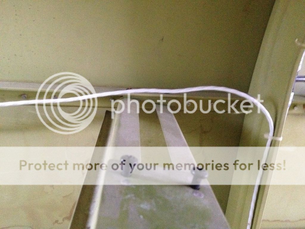

Old 02-08-2017, 10:36 AM
flyboy1963's Avatar
Posts: 2,434
Default one way to do it....
2 lengths of J-profile scraps, and a wedge under the longeron to produce the appropriate 8 degree tilt to match the unit in the panel. ( yours may vary)
This is behind the rearmost bulkhead, accessible, kinda, thru the tail fairing/elevator/v. stab attach point.
forward is -----> right. Not my install, but must credit the builder!
Perry Y.

Old 02-08-2017, 06:06 PM
LordofWar LordofWar is offline
Join Date: Oct 2015
Location: Ft. Worth, Tx
Posts: 80
Thank you Robert and Perry for your input and sharing the picture. Gives me some perspective. I'm planning to install it in the back of the fuse, closer to the tail (If I can get the bracket finished)
