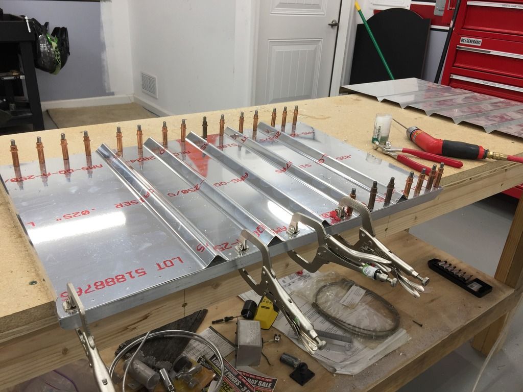

Contemplating the -10 wings this weekend, with almost nothing in the way of starting the bottom skin close-out, I wanted to ask a few questions.
Obviously I need to run static/pitot/AoA tuning and conduit (and might as well pull wires, too) before close-out. It looks to me as if the aileron bell crank, push-pull tubes and the roll servo (Dynon, most likely) would be 1) much easier to install now, and 2) not really in the way of bucking the bottom skin rivets - yet the plans list the bottom skin before the aileron hardware. Is this for some good reason that I don't see?
