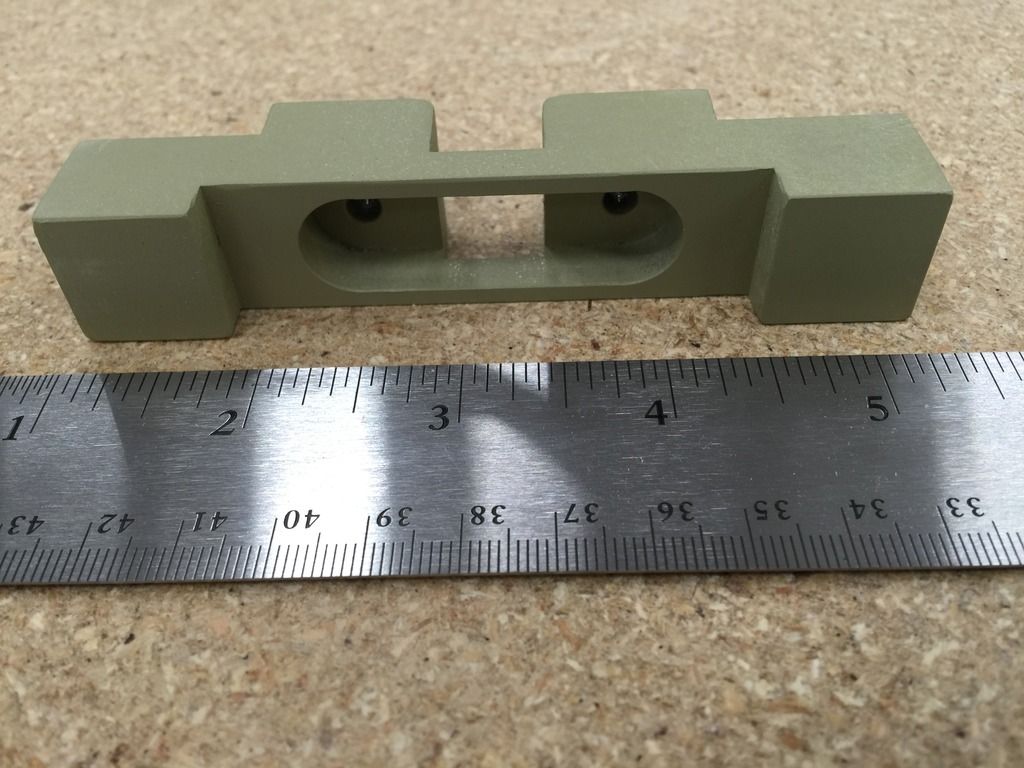

Default Mystery RV 10 part
Billet aluminum. Got separated from its bag-mates. From where I found it, I'd suspect section 11... no joy. Maybe I've been staring at these plans too long.
Can anyone ID this so I can tag it and bag it until I need it? Thanks!
Methinks this is some aftermarket part, you might not find it on the plans.
No idea what it is........

Most curious. Maybe part of an alternative plumbing scheme in the tunnel. (If so, don't worry - I'd never depart from Van's fuel system.)
I know! It's a tunnel heat-blocker AND a secure door pin containment system all in one. Made of unobtanium. And I have the only one
Maybe someone else has seen this thing somewhere.

A completely screwball idea that has worked for me.
Step 1) Take a photo of the part on a piece of white cloth with nothing else in the photo but the part. (You may want to shoot multiple angles)
Step 2) Go to Google images and click on the camera icon in the search box.
Step 3) Upload your photo and let Google do all of the work
My 2?...
