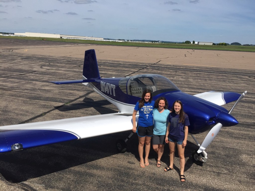

As promised, here are some pics...
These first 3 are before the flight, before it was covered in bugs.
I need to get the wheel fairings done...it's kind of RV-12 looking, without them, and although RV-12's aren't ugly, they aren't as sleek looking as the bigger RV's either.

Here are some from the flight itself. It really flew well. I stayed right around the airport, overhead at first, then after I saw it was all very controllable, I did some flights down the runway.

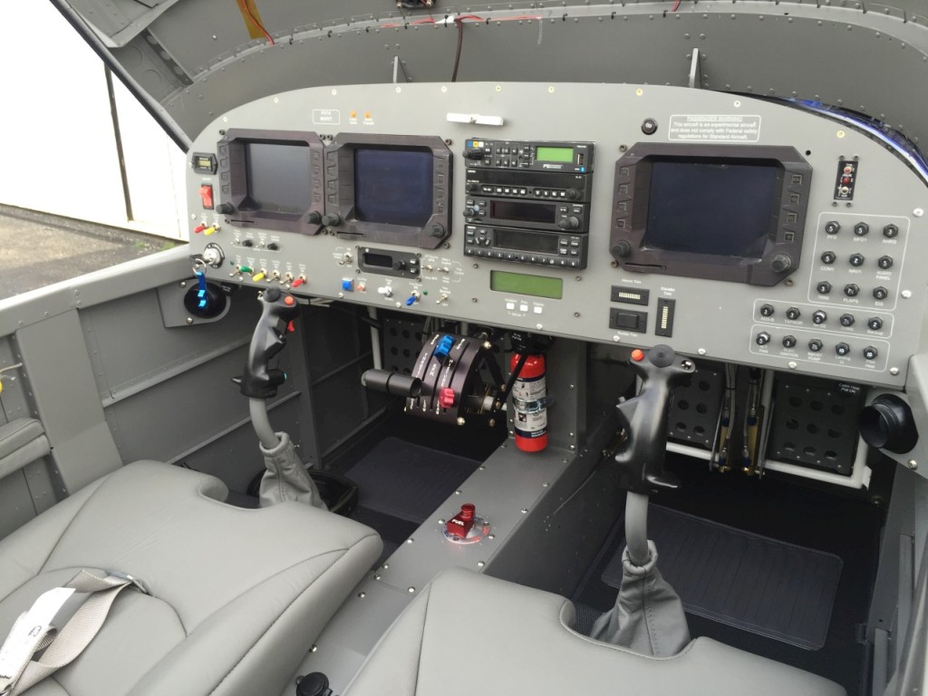

Here are some pics of the interior so far. It isn't 100% complete, but it's nice so far. Everything is from Abby at Flightline Interiors. She's a busy gal, so it may take some time to get things, but they come out great.
Incidentally, if anyone wants to use that logo that's on the seats, it's available. I designed it with my daughter, to represent the RV-14 being both aerobatic, and an IFR capable cross country plane, but you can read the pic for whatever you feel it is to you. Abby has the stitch pattern so you can just tell her the colors you want.

Congratulations! The seats look great and I really like the throttle quadrant.

What color/product did you use on the interior paint? It looks awesome.

For the Interior of my RV10 I used PPG Concept, DCC 34986 Gray. I liked it because I don't like light colors inside...too much glare on the windows if you take pics. Even this isn't that dark, but every little bit helps. For the RV10 I also added a flattening agent for the panel to make it less reflective and more eggshell. No reflections in my eyes if I can avoid it.
For the RV14 they took that same color code and mixed me up some PPG Delfleet single stage using that same code. This one doesn't use a flattening agent, but instead they just reduce the amount of glossifiers (if that's a word) that are in the paint, to get the proper finish. I There are areas like my seat backs that got pretty dull due to the way I sprayed them but in general I wasn't working hard to make the interior perfect..it's my intention to cover most every bit of aluminum I can. Up here it gets so cold in the winter that the last thing I want is to be able to physically touch the skin. So the paint is just there to give a good base to stick things on, and for now it makes a good color.
The throttle quadrant in my -10 I covered the sides with a vinyl with underboard stuff to give it rigidity, and mounted a USB power socket in both sides up ahead of the mechanism area. So that is where we plug in ipads and phones. I have to make one yet for the -14. I'm not as fond of putting it on the tunnel top like it is, because then you can crush it with things easily.
