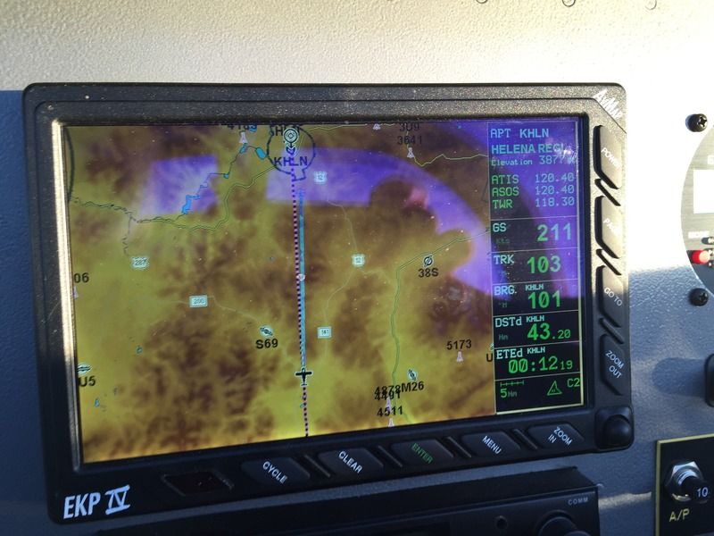

It's been a lot of work being our own General Contractor and babysitting subs. but the commute isn't too bad some days. 4.5hrs to drive it each way or 1-1.5 in the RV. Great tailwind coming home a few days ago.
