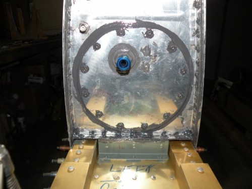

I sealed the nutplate rivets, but it isn't really necessary. If you reinstall your cover plates like the photos below (sealant only, no cork gasket), they won't leak. I used Torx head screws to make them easier to remove if it ever becomes necessary.
