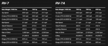

And how many of them cruse at 190 mph?
Almost all RV's can do 190 mph cruise, My 150hp RV4 cruised at 190 mph. Reason I picked my first RV in the late 80's was they did what Van's said they would do. I am currently helping a RV-12iS builder do Phase 1 and train. It is spot on book values.
