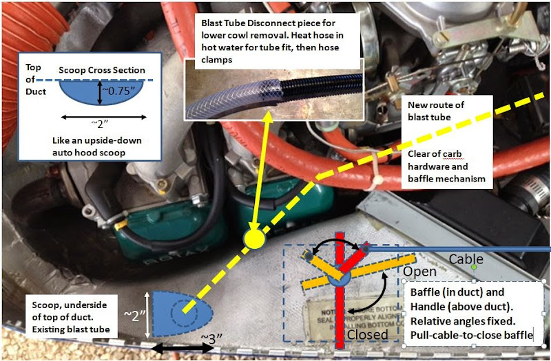

Today I did a test of airflow into the liquid coolant radiator duct at idle. I taped a wooden dowel well into the duct, well to the right of the oil cooler. I had ribbon streamers on the dowel. I started the engine, ran it at 2200 rpm, and the better half videoed the dowel. There is ALL KINDS of airflow into that duct at ground idle!
So I intend to proceed with my plan as shown in the picture below.
Issues:
Not real hot about the idea of having the VR in the cabin.
Think that a scoop as shown will provide SUBSTANTIALLY more VR cooling airflow at idle (and perhaps airborne) than the current blast tube source.
I want the location to not interfere with the operation of the Bender Baffle.
I intend to use the existing blast tube, not a larger one.
The connector for the blast tube will come off of the scoop at an aft angle, not at 90 degrees.
I think relocating the regulator itself into the duct at a point forward of the Bender Baffle will have some space (and maybe support rigidity) issues. I will recheck that when I take the cowl off; it is still a possibility.
I also intend to move the oil cooler forward by 1 inch based on the already-shown-here-on-the-forum mod for that.
I'll have pics after I make this mod in late April-early May (2015.)
I had also been wondering about the heat shield idea, I may add that as well. If it is too big though it could mess up airflow in that general area under the cowl. Basically I am thinking just a small vertical piece of aluminum just to block radiant heat from the exhaust.
Comments on the plan are welcome!

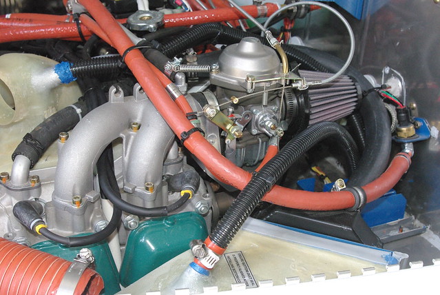

Awaiting the Sikent Hektik which is on order I installed the third Ducati today which I always carry as spare since the first one let me down at a bad location for parts.
This time I enlarged the outer cooling ribs up about 2 inched fitted with heat conductive paste and keft the blow tube where it was.
Also fitted an aluminium heat shield between exhaust pipe 4 bend and the regulator about 4 inches high and 4 inches wide.
Fitted a few thermal indicators to detect any differences.

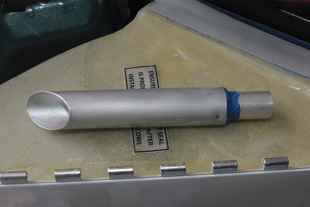

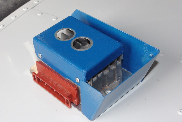

Firstly we made a simple blast screen around the VR - blanks off one side and the front. The theory here is to stop hot air from the upper levels of the coolant rad from feeding straight onto the VR.

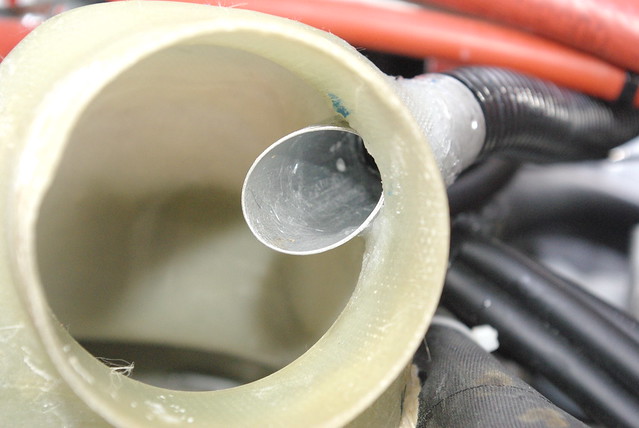

We had cut the original blast tube at an angle to try and catch a bit of breeze sometime back. It now sports a bit of extra tube slipped inside it to bring the blast tube further into the scoop and to align it into the airflow. Its held in place with a couple of tyraps that are themselves covered by the inlet SCAT ducting.

.... (with apologies to Aerofurb, Bill and others for shamelessly stealing their ideas :) )
As my long awaited first flight is still delayed while CASA proceeds at glacial speed to implement a fairly straightforward legislation amendment that is affecting a number of Australian builders, I thought I might as well use the downtime to try to improve the VR cooling. Nothing new or radical here, except that I decided to have two blast tubes feeding the VR cap instead of just one. Easy to do, and seemed like a good idea. I glassed a 7/8" dia tube air scoop into the shroud inlet duct and another one into the top of the radiator duct, and connected both to the VR cap. The radiator inlet tube hangs down about 3" inside the duct. Also added a heat shield (the bottom is unpainted) with heat transfer paste under both the VR and the shield. The front of the shield is angled mainly for easier access to the AN4 bolt.
Shroud scoop:
Radiator duct scoop:
Heat shield:
Assembled:
Is it necessary and will it work? I don?t know, however our summer temperatures are often up around 40C (104F), so it's worth trying. If the regulator fails, then either the modifications didn?t help, or perhaps I just had a bad regulator, or both. If it doesn?t fail, then either the system works and/or maybe I have a good regulator.

I modified our coolant radiator blank today (see pic above in post #66) so the only taping of the holes is now the top 4 rows.
This means the coolant rad is blanked off above the cabin heater ducting area - so no air blowing towards the VR.
VR area temp was about 20 degC less during the pre flight warm up and power checks (allowing for small OAT change).
This has dropped the air temp inside our 'extra' blast screen by around 13 degC in flight over what we had in the previous post with respect to OAT (ie for similar OAT).
