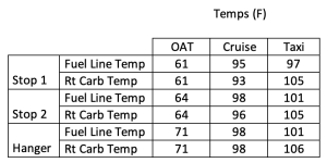

First flight after installing foil-backed fiberglass insulation on fuel lines FWF and permanent install of 2-channel temp sensor.
One hour flight to three outlying airports with 57 OAT. Fuel temp was 66F at completion of engine warm-up prior to first take-off. Fuel temp stabilized in cruise flight on first leg at 83F and highest fuel temp was ground ops at 90F. I decided to do full-stop landings with taxi back to check temps.
Can’t say a whole lot more until OAT become summer…

Another data set from flight on Tuesday morning. The day actually got quite warm (80F) but winds late morning-on were gusting 28, so I flew early morning. Engine ran well with solid fuel flow and pressure in climbs.
OAT temp was 61-71F.
No conclusions can be drawn from data. Still anxious to see fuel line temp and under-cowl temps when weather gets really warm.

How are you instrumenting the fuel lines? I’m wondering if you are measuring engine compartment temps as opposed to fluid temperature which, given the insulating effect of the hose and fire sleeve, could be much lower than the outer wall temp of the hose and fire sleeve. My guess is the critical temp to measure is the tank temperature. I do find that after 45 min cruise at 8 or 9 thousand feet in Phoenix summer heat I can usually secure the electric pump in cruise without any indication of flashing in the fuel line. My vapor lock indications have always occurred during initial climb in the summer.
Rich

Today was first day I had to try my cooling fan to help vent under-cowl heat when plane is parked. OAT was mid-70F and I parked the plane for a twenty-minute potty stop. I placed the cooling fan over the open oil door and plugged into the receptacle I use for battery charging when in the hanger.
The fan works incredibly well. Lots of heat pulled out by the fan. When I came back twenty minutes later the fan was blowing relatively cool air. I still run the electric fuel pump for several minutes to recirculate fuel from the tank prior to engine start and flight continuation.
See post…. https://vansairforce.net/community/showpost.php?p=1522183&postcount=135
