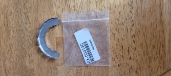

That does look nice. My heat muff is working ok, but I had read in this thread that the ends often fail, or get loose. Seems that you can buy new ends, but they are only for RV-14 builders. I've also read that Van's is considering a new end that's more robust, and will hold the heat muff tighter.
https://store.vansaircraft.com/ex-00013k-l-set.html
While I might need to just buy a new one for $200, I'd rather buy just the ends and use the rest of that money for 2 hours of gasoline. :D
