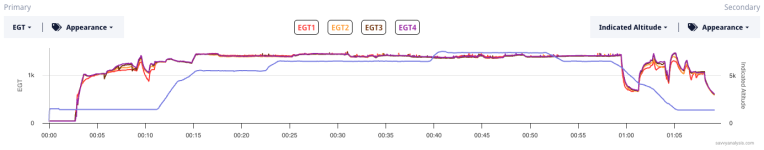

I feed mine 91E10, 93E10, UL94, ethanol free 90 in proportion with 93E10, and one time when I had just over a half tank of UL94 I filled up with the 87 at KAPT/Jasper, TN to make it home with required reserve, etc. and it handles any and all of these blends wonderfully and at 4 gph!
Standard mags?
One Slick and one Lightspeed III, AFP FI and boost pump plus Tempest mechanical fuel pump.
Also and probably most beneficial, a constant flow return line and overall a very cool running engine.
My motivation for using unleaded gasoline and experimenting with mogas was mainly because I can.
The threat of 100LL going away has been advertised for years and deadlines have come and gone.
The glacial pace of gumbiment approval is yet another reason to find an alternative before you are forced to put paint eating
"approved" fuel into your wing tanks.
At least on my installation, there is no need to make adjustments by switching from mogas to avgas since I carry both most of the time.
Only if I analyze engine data can I see a very small increase in EGTs (between 10 and 20 degrees) when switching between mogas and 100LL.
I find that I can lean just a bit more on mogas than 100LL before I notice roughness.

Wondering if you have done an in flight switch of mogas in one wing and 100LL in the other? I have, and the EGT and CHT behavior of the two fuels is very noticeable. Disclaimer - my experiment was with California summer blend auto fuel from the corner gas station.
It does run, but clearly the two fuels I used need their own distinct ignition and mixture maps to run “right”.
Tried this today, and could not see anything material when changing from 100LL to MOGAS. Flew at 5500, 6500, and 7500. RPM at 2400 and 2500. FF from about 8.5 up to 10.5. Tested at peak EGT and just a tad bit lean of peak.
This MOGAS is delivered from a pump at the airport, so is probably not the same as corner gas station gasoline. I'll have to try that next, first BP 98 and then BP 95.
Thanks for the follow up. Did you happen to take note of your ignition timing during the switching?
The “gasoline” (using that term very loosely) from California is an unknown witches brew that probably varies in chemical makeup from County to County, so hard to consider my experience a baseline for comparison. But it does give me hope the stuff I can get here in AZ is better/more suitable for aviation use.
Maybe not on your field, but on mine it is.
I made some investigation a couple of years ago, and found out that the dino juice delivered to our airfield pump is also supplied to the local auto gas pumps in the region.
I didn't watch the timing, unfortunately. And my EI Commander does not log to my EFIS - something the EngineBridge can do. Typically when flying under these conditions I see between 25 and 28 degrees, and often as high as 32 degrees. Looks like I'll have to run another test!
