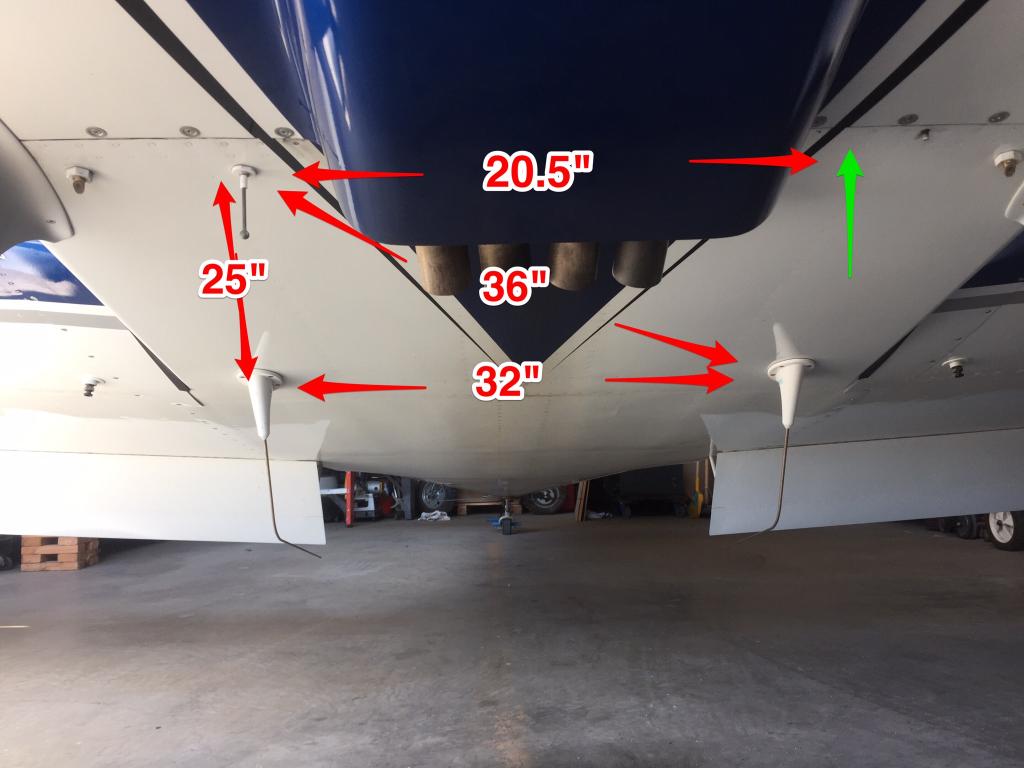

I had the same concerns about Uavionix’s restrictions for the antenna location. I emailed their tech-support the picture below and ask them if would be OK to mount the antenna where the green arrow is located. They replied that it should be fine. It required less than 3’ of RG400 in that location. It has passed all the test and is working well.
Wow. Thanks for the pic/info. I?ve been trying to accommodate the not less than 1 meter requirement as noted in the manual. That location sure will simplify things!!
Disclaimer
Disclaimer: Consult with you Uavionix before placing your antenna outside of their recommendations. They gave me the blessing to mount it where I did and it seems to be working fine. I?d hate for someone to have a problem based on my recommendation.
...angle of the pic not withstanding, I'd bet a case of beer your pipes (all 4 of them) are giving you some shielding (or shadowing as the case may be) between the xpdr and echo antennas....
Understood. My transponder antenna is quite a bit aft, more than the required 1meter from the proposed adsb antenna location. Only antenna I would be close to is my bent whip like yours, but I think I may be very close to 1meter away if I place it where your txpdr antenna is. I was concerned with that forward location not having enough of a ground plane forward of it. Apparently that has not affected function for you?
